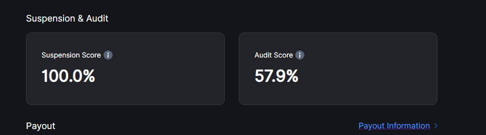

I saw those satellites had audit score low.
Try to search your log for “GET_AUDIT” and “failed” together.
Did fint much, just 2 file not found. The thing is I guess those satellite has connection problem to US or my particular ISP. Since both nodes of mine had the issue with those. One node is like 3 weeks old. the other 7+ month.

Your node was disqualified for failing audits since DQ for downtime is currently not in effect. You need to find out why your node was failing for those satellites.

In the satellite logs I can see that you didn’t had the data.
error: "file does not exist; piecestore: (Node ID: 12RkpMXYS7tNZ5W5yRTEmPxGEbsiA2MrW5N2jk46jNzXRUdvaXV, Piece ID: M5HKDMTK7TSHPMLMKUUQPCYWGGLRNRP5VZCNBLEWGN4UM6TFGVLA): file does not exist"
error: "file does not exist; piecestore: (Node ID: 12RkpMXYS7tNZ5W5yRTEmPxGEbsiA2MrW5N2jk46jNzXRUdvaXV, Piece ID: 73YE5LVWKGJCGOKPGKICGLUFZ5X7HFY4BL47Y36SQDQY4PZ4ZFZQ): file does not exist"
error: "file does not exist; piecestore: (Node ID: 12RkpMXYS7tNZ5W5yRTEmPxGEbsiA2MrW5N2jk46jNzXRUdvaXV, Piece ID: FB3BDIKGGPQO3OVRT76YR7FMNJCTRXEUZJKIFC72KFAYKKI3ICDQ): file does not exist"
These are just the last 3 error messages.
