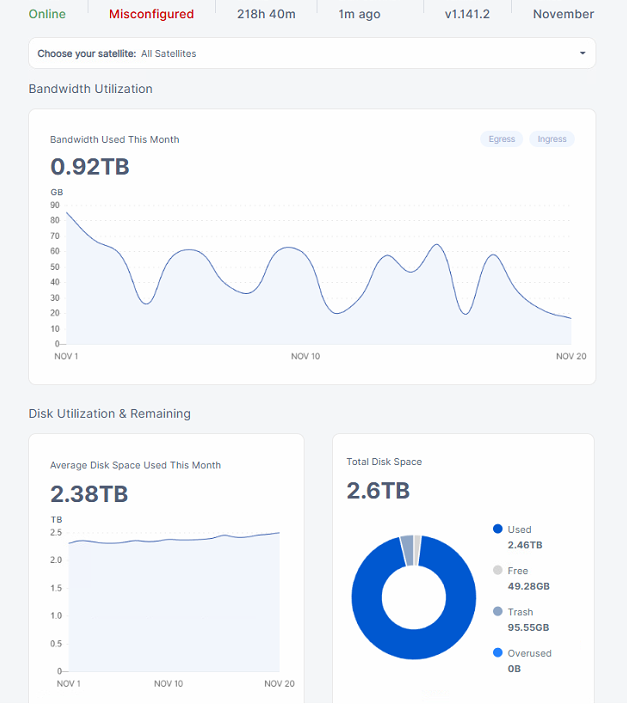

Node failed to calculate data changes online
Somewhere is error in space calculation.
This node is 218h in running in row

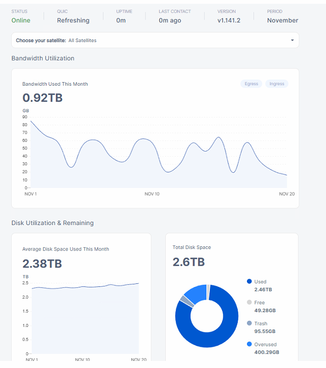

and below is after restart, no configs was changed just restart.
looks like it forget about uncompacted garbage at all and not stopp upload new data till it hitt disk full.

Yes, it not stop ingress till hdd is full.
I dont use dedicated, because it not show stats then.
It overused about 400GB so it not only visual bug.
when node start it looks like it read it all as should do it, but after some time it go totally wrong.
