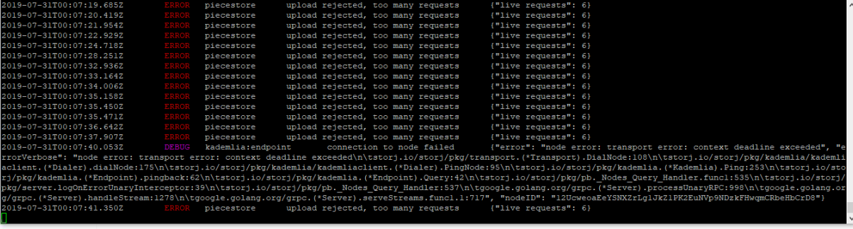

So after his updated to 16.1, I noticed that my node is only showing upload rejected. It keeps showing upload rejected continuesly in log file. I know upload rejected is limiting the number of cocurrent connections but it just keeps going. At no point do I see the typical upload failed message and then after an upload started to signal the node is processing another request.

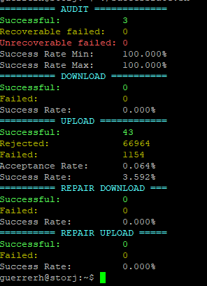

What the result of this script: Script: Calculate Success Rates for Audit, Download, Upload, Repair?
I had rm the node and recreated it not to long ago so the stats will be only for the past 22 hours
