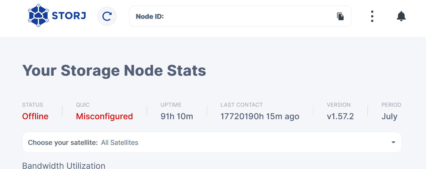

Yes the node is running.
Your node is not reachable from the internet, so something is not configured correctly.
I suppose when you check your address and port from the node configuration on yougetsignal - the port is closed (you should put address from ADDRESS parameter to the Remote Address, port to the Port Number)?
And if you check it with IP address is it closed too?
Do you have some firewall?
Yes i understand that. It seems to come from Docker since the port is reachable with the other command (see the screenshot at the beginning of this thread).
Do you know of any way to fix Docker not working correctly or diagnosing the issue with Docker?
Both the ip adress and domain show a closed port with docker/storj, and an open port with the other command.
I do not have any firewall rules. With the other command, the port is stated as open, so it goes through correctly.

Affirmative, there is just the domain, no ip address specified. The domain resolves to the correct ip address.
Yes it works fine, see screenshot below :
I do not have any firewall enabled and running.

I did specify the -p option in the command above, can you confirm that the command is correct?
Regarding the other points, unfortunately I checked everything and it doesn’t seem to be related to any of those :
The local ip matches the NAT rule, it’s a fixed local ip on the router by mac adress of the server, that’s not going to change.
The external ip resolves correctly on that domain, there’s a ddns service running and actualizing regularly (on another computer locally on the same network)
I checked for CGNAT but that doesn’t seem to be the case since the port is “open” when I use the other command (meaning it matches and goes through). Storj worked fine on the other computer too before the migration.
The identity is signed and it was working well on the other computer, I don’t get any error regarding an unsigned identity on this new machine, the identity files are in the right folder and working correctly.
I’m really at a loss, node has been offline for way too long now, I’m going to lose the data I have. I think it’s a docker problem.
