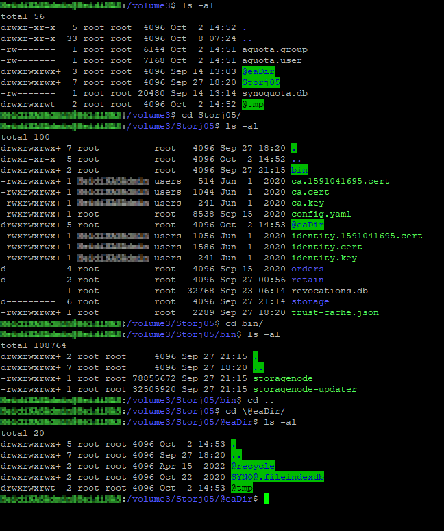

I have read the post linked by you and don’t know wheather my exec rights are set correctly. See:
Luckily I have one stable node running. I compared the file right. I have done the following changes. It seems to run properly now. I have to keep watching though.
It requires the exec permissions options for the mount and +x permissions for these binaries in the bin subfolder of your data location (the last one seems already applied).
