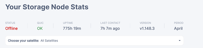

Node offline, but I could not locate the cause of it
My node appears offline on the dashboard. I have checked the following:
Port 28967 is open. DDNS is working. (Checked on https://portchecker.co/ with server address of the node.)
New connections can be established, checked in docker logs storagenode
No errors found in logs, at least for the last 200 lines.
What could be happening?
Full browser refresh or restart make any difference?
No, I’ve tried hard refresh and used another browser too.

This is looking like a perfectly working node. So dashboard might be wrong about online status. Maybe a time sync or time zone problem?
Yes, my PC had the wrong timezone because it has two operationg systems. But after correcting it and hard refreshing the dashboard, the node still appeared offline.

  • did you check .lastPinged value and compare it with current time on that host? If node is “working fine” and actually receiving and sending data to all satellites (you might want to filter longer log and grep unique satellites), then the possible culprit is, as alpha rabbit pointed out, mismatched time zone: if the difference is more than 2 hours, the lastPinged will not pass the threshold test from any satellite.
  • did you check log of your DNS update, to rule out ip detection shenanigans, resulting in wrong IP being provisioned intermittently?
Problem solved. Nothing wrong with node, checked all 4 satellites, all reported last contact of 0 min ago. “Status” went back “Online” again. The cause was simply mismatched timezone on my personal computer (Not the host running the node). Thank you all for your help.
