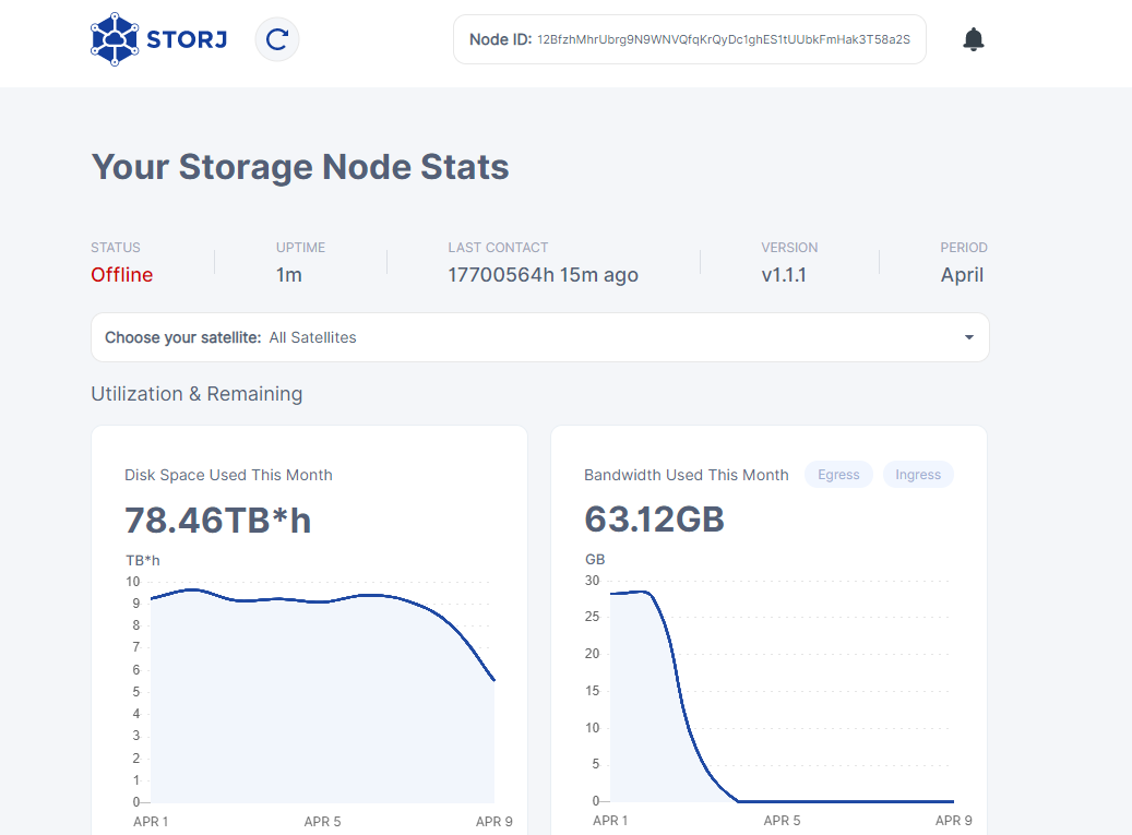

I checked my node and found out is has been offline for a few days.
it says at the notifications that it needs to be updated to v1.1.1.
but when i check the dashboard it says that it is running on that version.
i also updated docker to the latest version.
can anyone help me to figure out what is the problem?

The notification won’t go away after you have updated. There is another thread about that but I cant share it as some of my messages where deleted.
I checked the port and it said it was closed.
I checked the router and for some reason it was reset, losing all the port forwarding info.
I made a new rule for the port and now it is online again.
