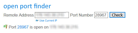

Checking port from outside (works before because windows firewall and router port forward configured properly (I have public IP):

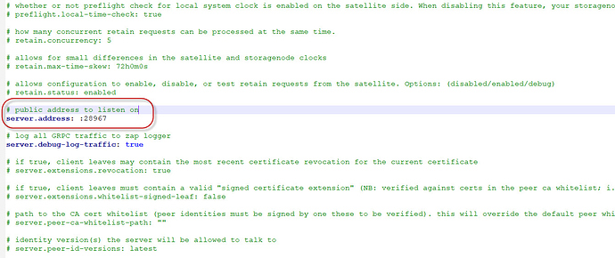

And this in config.yaml file:
Is this correct? Do I have to wait until satellites recognize new NODE on network?

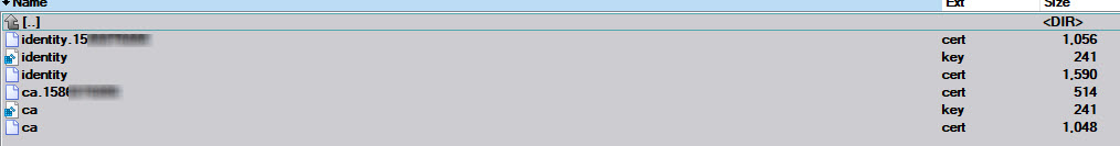

No, its instanteous. You should see ONLINE status right away. Can you verify if your identity folder has 6 files in it?
Yes I have six:

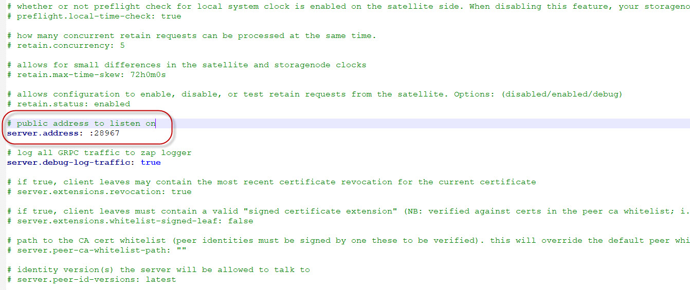

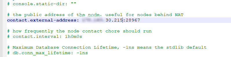

Hmm only :28967 seems to be open even I open both 28967 and 28968 and tried one and another running but still offline. Strange…tried reinstalled GUI configured only with
public address to listen on
server.address: :28967
and
the public address of the node, useful for nodes behind NAT
contact.external-address: 178.xxx.xxx.215:28967
Port checker green. I have on the different internal IP SYnology NAS where other NODE is running with this configuration and port forwarding seems work without problems:
