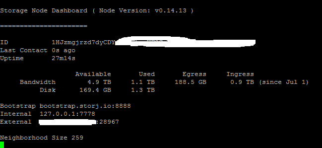

What is the Last contact says?
What is your OS?
Please post the provide the docker run
command that you’re executing, the full log and the check that you’re using the last docker image.

My OS CentOS Linux release 7.6.1810 (Core)
You still not answer about the Last contact on your dashboard.
So, the node work, just no traffic?
If so, the tests are stopped at the moment
ok!! thanks for the answer
