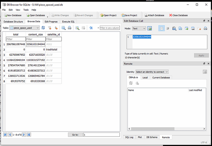

I found that if in database I put together All rows from All sattelitses event not existing any more then node will be full.
Screenshot 2024-07-22 135450
Yes, it could be a root cause, however, you said that the API is showing the correct value?
What would happen, if you would remove these obsolete rows manually or with storagenode forget-satellite --force <the satellites list here>?
I tried to remove first row from database, where satellite id NULL in database, but node started to show 0 space occupied at all, so i restored file from backup.
forget satellites was done already on this node in the past, i remember that elec written somewhere that, this forgotten satellites wasn’t wiped from DBs.
I think you need to delete only rows with satellite_id filled. Those with NULLs seems to me like a header or a subtotal.
And if my guess is correct, you also need to reduce the amount in the row with NULL satellite_id on the deleted amount.
I still didn’t get an answer about these numbers in that database.

yes i calculated with 1024 bytes. and bottom number is all total of aal rows.
I deleted rows from old satellites but nothing changed.
Yes, it’s kind of expected, if the reason not in reporting the node as full. And it shouldn’t be accordingly your data from the API.
