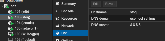

Turned out I had to set up DNS IP in LXC container settings. It was empty by default and optional. I’ve set it to 8.8.8.8 and node came online. Why did it become necessary after 10 months of smooth working? Who knows.

Can you elaborate a bit how/where it’s done?
Sure
This makes zero sense. Looks like you have multiple issues. DNS settings don’t make files in users local home unreadable. Restarting the container after setting dns is what made a difference. This time. It will fail again. Because you did not find, let alone fix, the root cause
Look, during two days of digging into it I’ve restarted the container like two dozens times, rebooted whole server twice - didn’t help. And this thing with DNS is repeatable, I changed it back and forth several times to check for sure.
