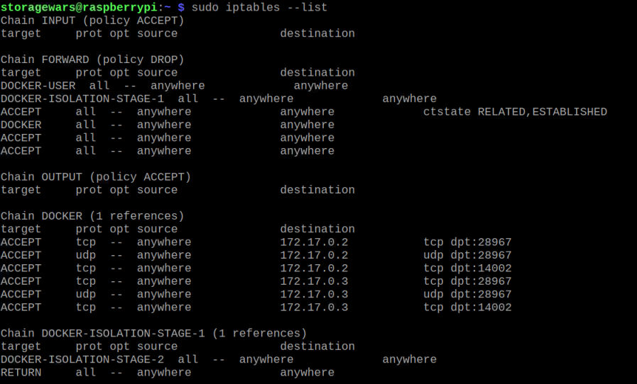

Hi there! i’m getting some trouble on one node! I’m getting QUIC misconfigured from time to time! It only happens since the instalation of the new STORJ version, and after sometime it goes offline !! There’s my confs
sudo docker run -d --restart always --stop-timeout 300 -p 28968:28967/tcp -p 28968:28967/udp -p 127.0.0.1:14003:14002
Here are some picks of the node and router port forwarding

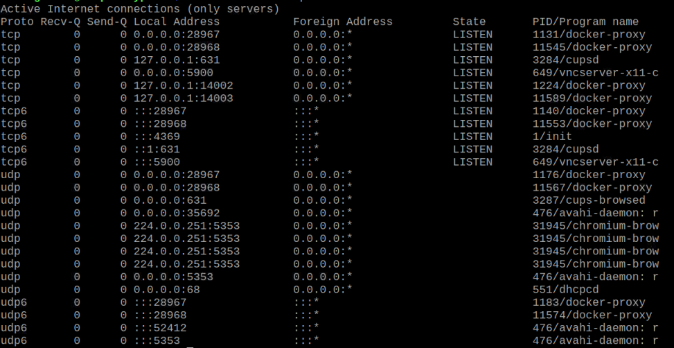

Running some commands here… On the pi i get this…
My question is : should UDP ports be “listening”? If so which should be open (listening)?

When i list all udp ports with command ss -lntu i get all udp ports unconnected! Should stay that way?
I can only pass that question to @Alexey
