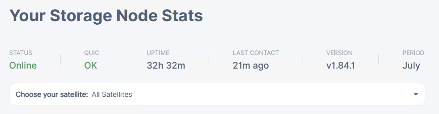

When I read your post, I was a bit scared since I also have a node in Windows 10 made with virtualbox from a few months ago that I wanted to see if I could do more with this configuration in the future. It will be about 32 hours since it has been updated to version 1.84.1 and it has not given me any crashes.
The virtualbox version I use is 5.2.18. It’s old but for what I use it for, it’s enough for day to day.

The node’s (VDI) disk is a dedicated network drive for it and works fine on a 10Gb/s port
The configuration of the “real” PC and operating system is:
If you can help us a bit how you have it configured, we can find out what is causing the virtual machine to hang.
