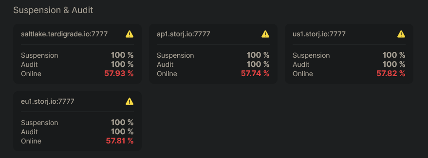

I noticed some of my nodes turned themselves off for no particular reason. Server is fine. There are even other nodes on it. They are fine. They did not turn themselves off. On those, who did, I see this:
What should I do? Delete them and create a new ones?

No. They were off. I assume after an update they did not launch properly and I did not see it for several days. Restarting them started them just fine and as you can see, there is traffic.
Suspension is at 100%, so I guess not to worry and just wait and give it time?
I still do see these notifications, though…
Please advise whether I should perform any action on such nodes. Thank you!
No, just keep them online. To fully recover the online score they should be online for the next 30 days. Each downtime requires additional 30 days online to recover.
