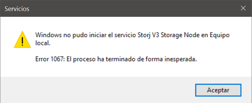

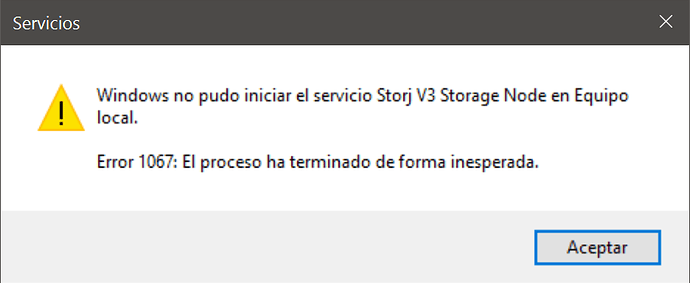

Well, it looks like I didn’t do something right. I added my DDNS name to the config.yaml file, and then I stopped the node and started it again, but it won’t start, I can’t access the Dashboard when I run it.

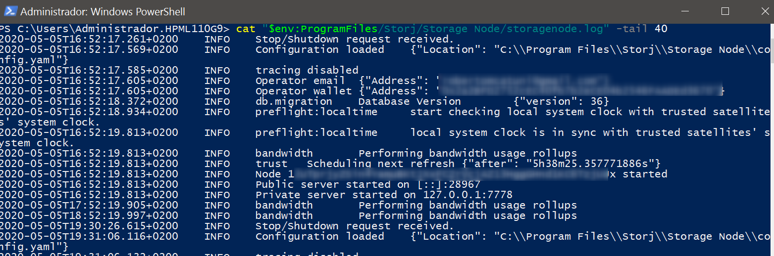

I have tried to start it from Windows services, but it gives me error 1067. And then I added this line to the Power Shell (which I’ve been looking for in the forum about this problem) and it threw me this. And I see that the DDNS name is not in the results.
You can always uninstall GUI and delete the C:\Program files\Storj folder then install it again. Make sure this time you fill everything. Test with https://www.yougetsignal.com/tools/open-ports/ if your port is open or not too.
