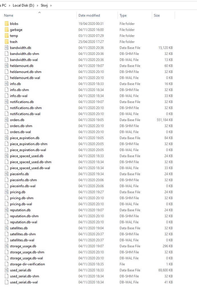

The file (folder) structure is not the same, check the screenshot! Is it because I’m using GUI windows version?
What version is your node running?
I’m running version 1.15.3
Is there a folder names orders in the root of the drive D:\?
Sorry Im not sure cause I don’t have a windows node to look at, I thought They both used the same stucture… But it seems like your looking in the wrong location.

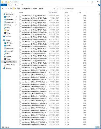

GUI stores orders\unsent folder under C:\Program Files\Storj\Storage Node

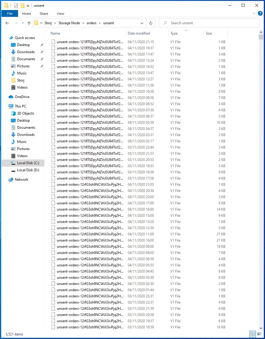

I found 5,521 files in the unsent folder, check the screenshot.
How to fix this unsent order issue for GUI windows version node?
Well theres no fixing it the old ones can just be deleted because they wont be sent again they expire after 48 hours. But you can try to figure out why its happening cause be a system issue, drive issue, There is something causing it. What causes it or a fix for it I don’t really have a solution because I havent experienced it myself yet.

Unfortunately there’s nothing indicating that the problem you posted is related to your node. The screenshotted problem was related specifically to a node that had expired orders in the (now depreciated) database. Your unsent orders are related orders contained in the flat files, which is a different problem caused by file corruption.
You did find and detect the issue with your node (and fixed it). Unfortunately you found the problem only after payouts. The Storj is aware of the problem with unsent orders and they working to fix it.
This project is maturing and getting better with every release. Personally, I have been supporting this project for over 3 years now. This project is definitely worth sticking around for. The Storj team has always been responsive and fair when it comes to problems, and I am sure they will do what they can to make this right.
So the issue in the screenshot I uploaded earlier was about expired orders in the orders.db file right? And my issue is unsent orders (files) found in the unsent folder that was not sent because they are corrupted right?
As I said before, I don’t know anything computer programming, I step up a storj node just to earn a passive income to help me pay my bills.
Check the payout screenshot below, If I’m not making any mistake, all orders for October was not sent because of file corruption and all files stayed in the unsent folder right?
Looks like.
