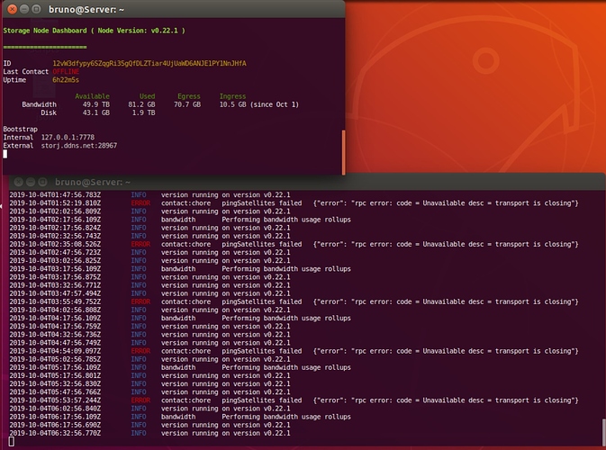

Ping Satellites Failed - dead after 0.22.1. update - Node Offline (Edited, new information) HELP?
Happen to anyone?
I double checked everything, port forwarding, router firewall, DMZ, you name it!
Didn´t change anything, my Ubuntu SNO died. Also, I was not DQ´ed.
Thoughts?

I am. Still not working and still showing offline. Manually pulled version 0.23.1
Log stating the same att v 0.23.2?
This is what I have:

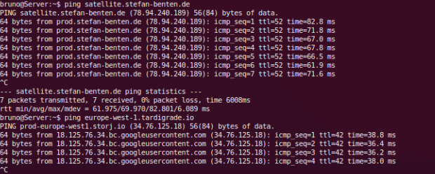

I don´t believe it´s a DNS issue, even so I manually changed it on resolv.conf
Even so, it´s Offline.
In addition, I ping successfully the Satellites with correct name resolution:
12EayRS2V1kEsWESU9QMRseFhdxYxKicsiFmxrsLZHeLUtdps3S | us-central-1.tardigrade.io:7777
12L9ZFwhzVpuEKMUNUqkaTLGzwY9G24tbiigLiXpmZWKwmcNDDs | europe-west-1.tardigrade.io:7777
121RTSDpyNZVcEU84Ticf2L1ntiuUimbWgfATz21tuvgk3vzoA6 | asia-east-1.tardigrade.io:7777
118UWpMCHzs6CvSgWd9BfFVjw5K9pZbJjkfZJexMtSkmKxvvAW | satellite.stefan-benten.de:7777 (Germany)
In addition, I just replaced my ADDRESS on docker run command to my external IP, and I´m still offline.
I´ve triple checked everything, and even open a ticket on my ISP to check.
I´m out of ideas…and I´m an IT profissional :frowning:

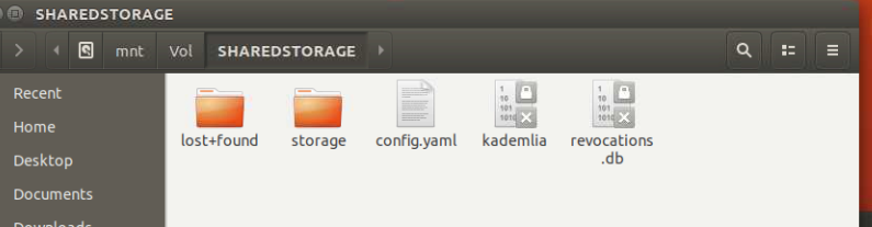

Is it supposed to still have this file structure on the Data folder?
