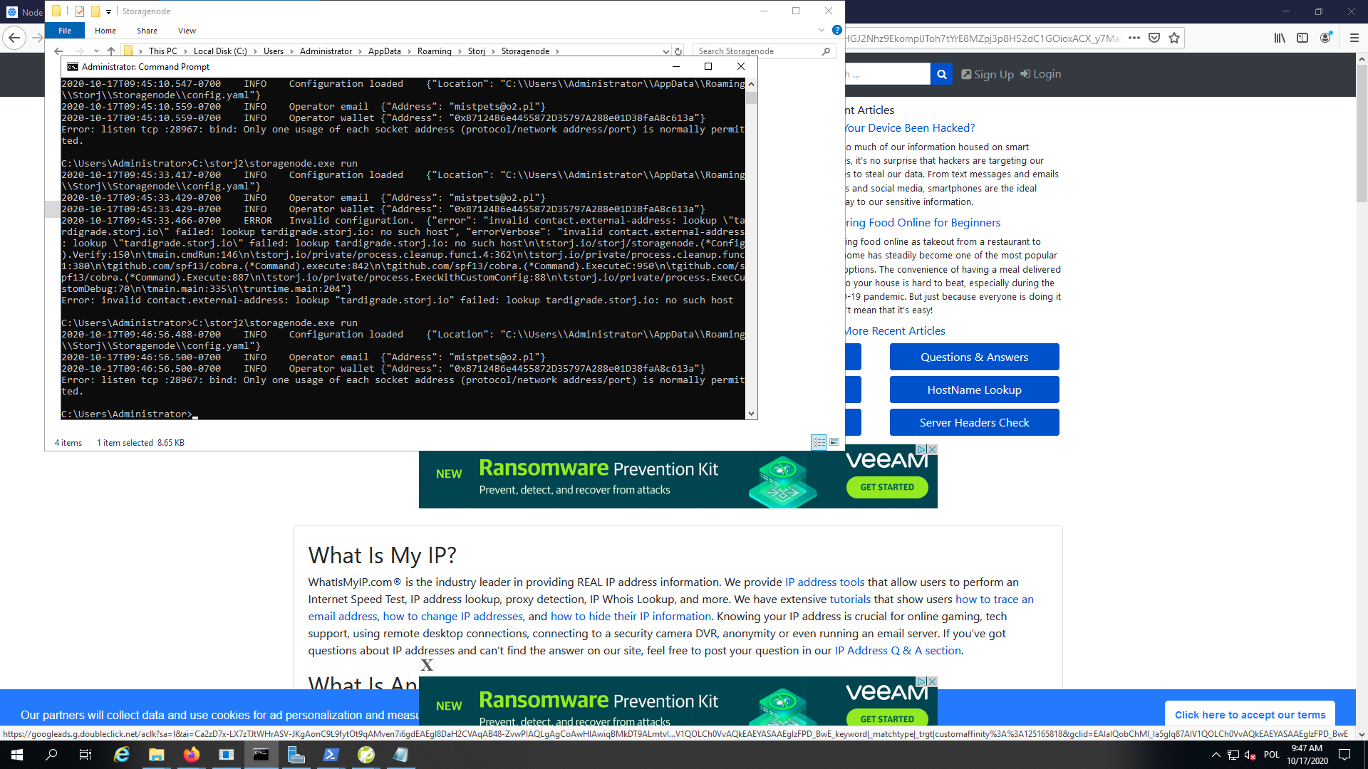

I’ve keep getting fallowing error:
I wonder how to fix it.
Hello!

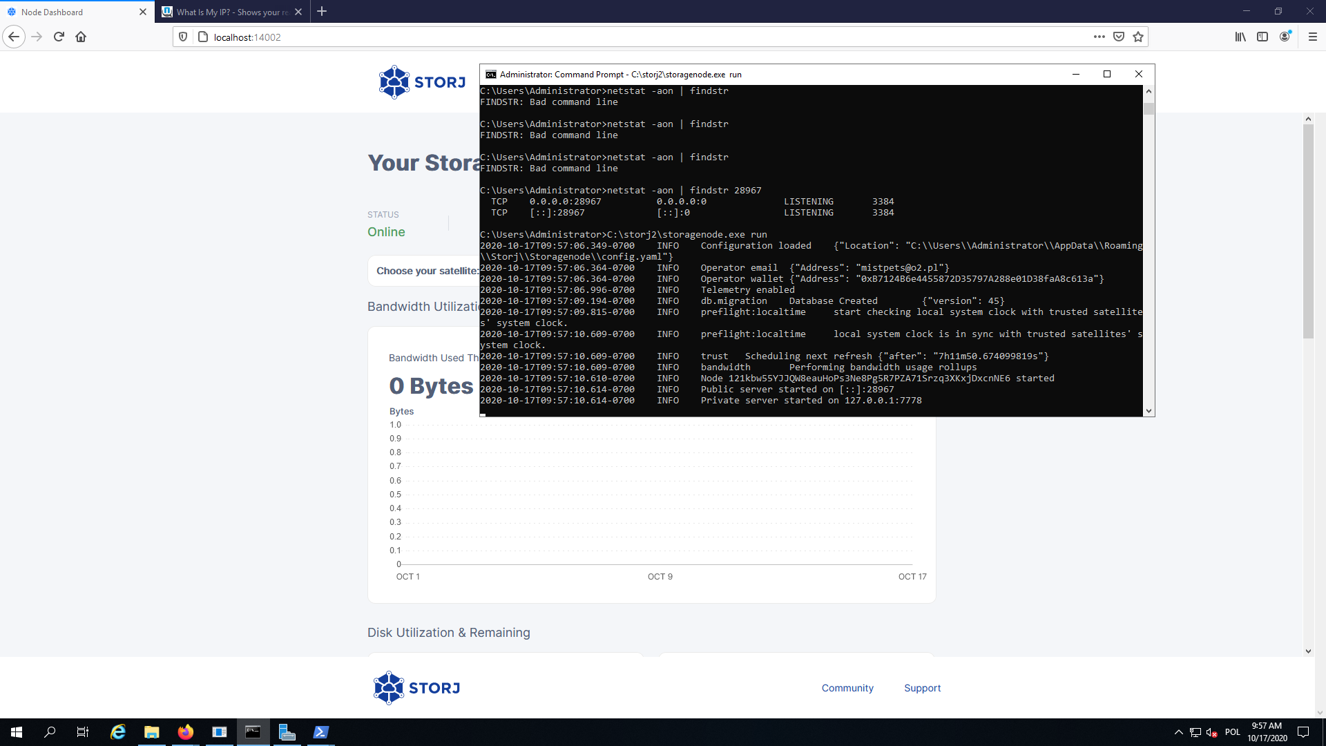

looks like since you’ve used storagenode2 in your start command that this is a second node on the machine, and the first is using port 28967. So you’d have to configure the second node to use port 28968
In powershell execute this command and show the result
Get-Process storagenode*
Is this the only node on your computer ?

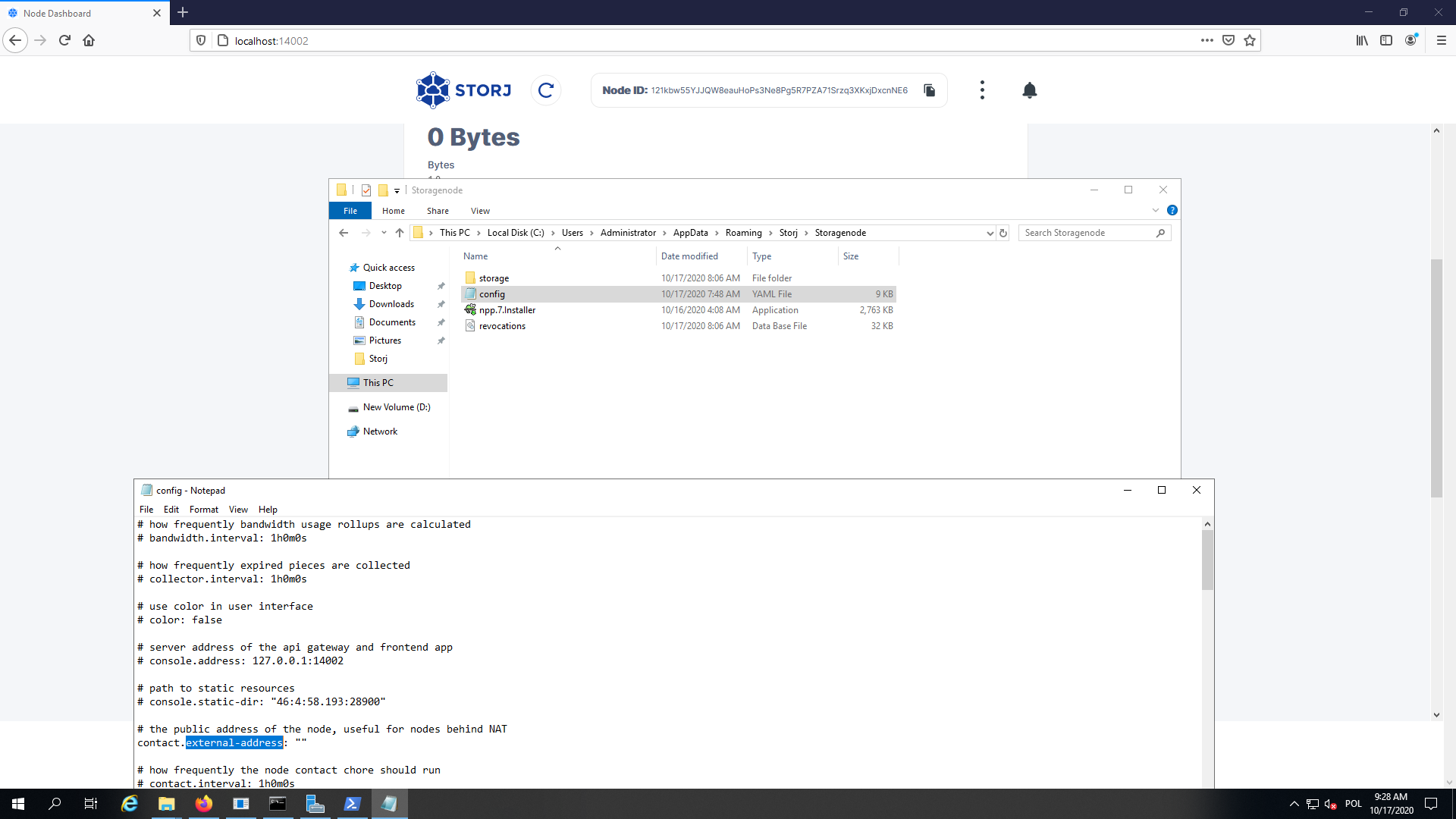

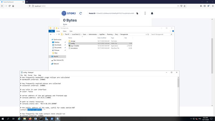

From config.yaml
file can you paste what is shown for contact:external-address
This is not the right file. config.yaml
file should be under C:\Program Files\Storj\Storage Node
It dosent “load” the file from the installation folder.
Can you elaborate ? What error or issue are you facing while opening the file?
If you mean the config.yaml none , its just dosent read from installation path

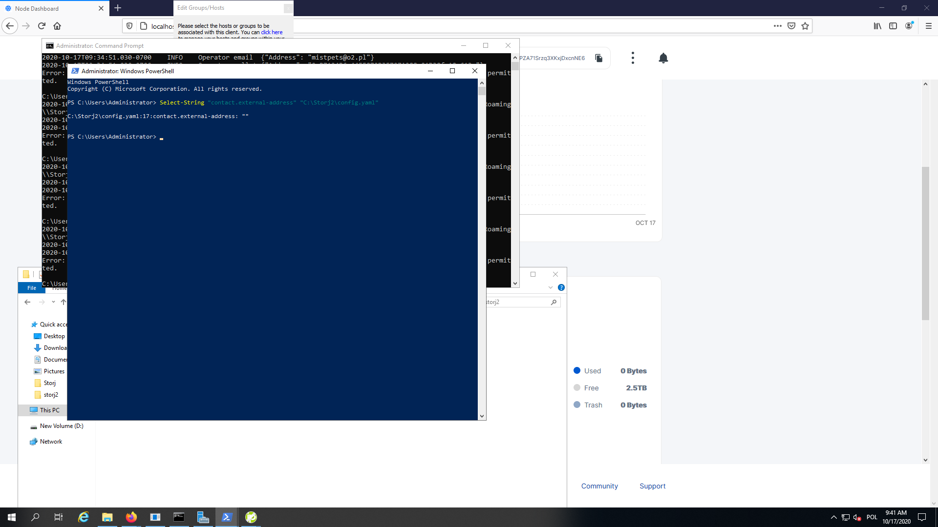

Try this in powershell
Select-String “contact.external-address” “C:\Program Files\Storj\Storage Node\config.yaml”
You haven’t specified a static IP or DDNS hence you see port error. Did you setup DDNS ?
