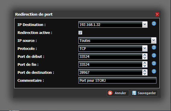

But i had a little? Problem when i need to forward my PORT. I’m living in France and my routeur tells me that i can’t “use” or “forward” a port under 32768 exactly “you need to chose a port superior to 32768”, so it’s impossible for me to root the port 28967 like asked with my routeur ?

Or if you can open let say 55555 and point it to 28967 in your router setting
I actualy did this, external port 33124 and internal port 28967, and everything else is configured with the 28967 port.

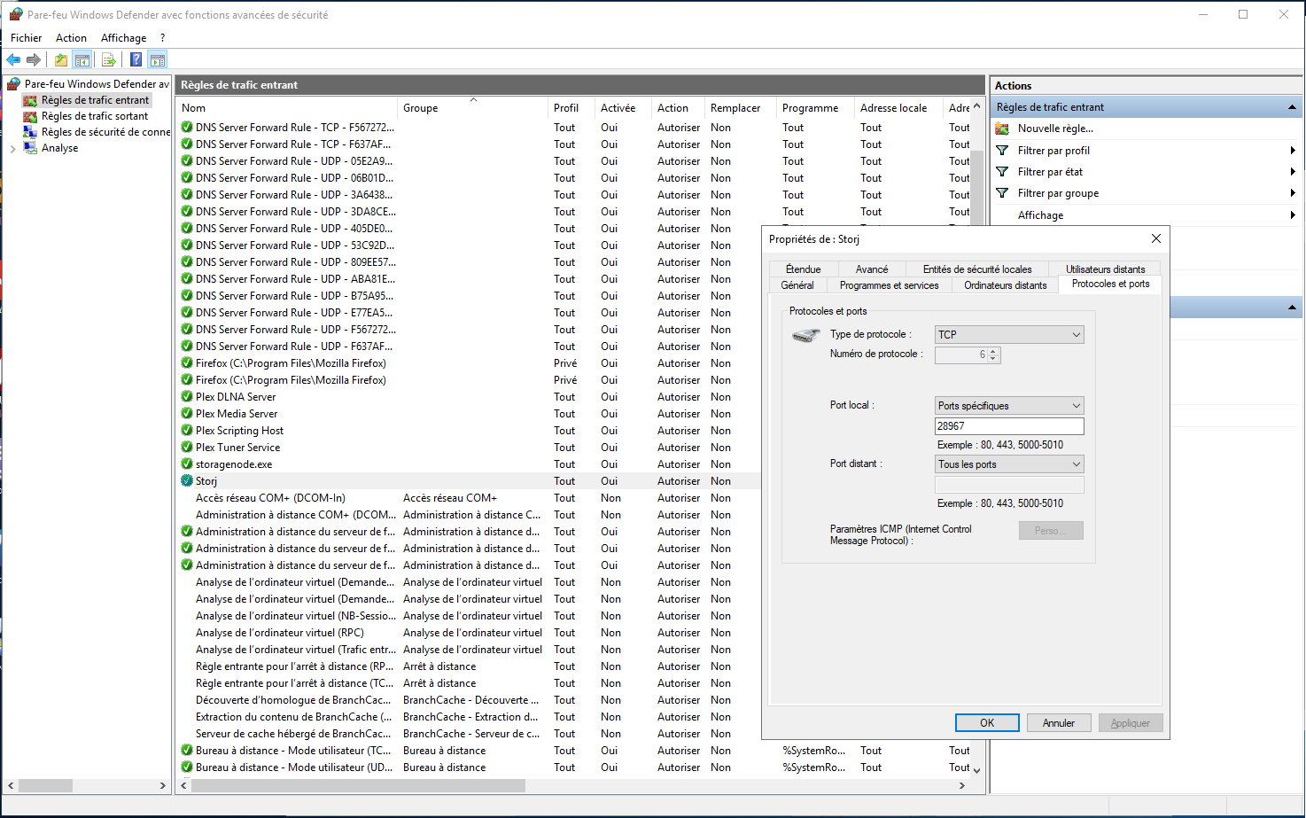

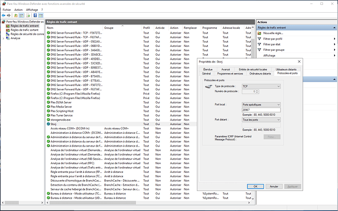

Please, enable firewall and dnscache service.
Don’t forget to add an inbound rule to the firewall for the 28967 TCP port.
Do what @Alexey said and i hope thats solves it for you.
I have only started nodes on Debian so there are ppl in here way better then me in that.
No problem John.A ! Thank you for your help !
And i already did what you asked Alexey, i followed the step by step guide of STORJ, Firewall and DNScache are already enable by default and i think i have properly set up the inbound rule in the firewall.

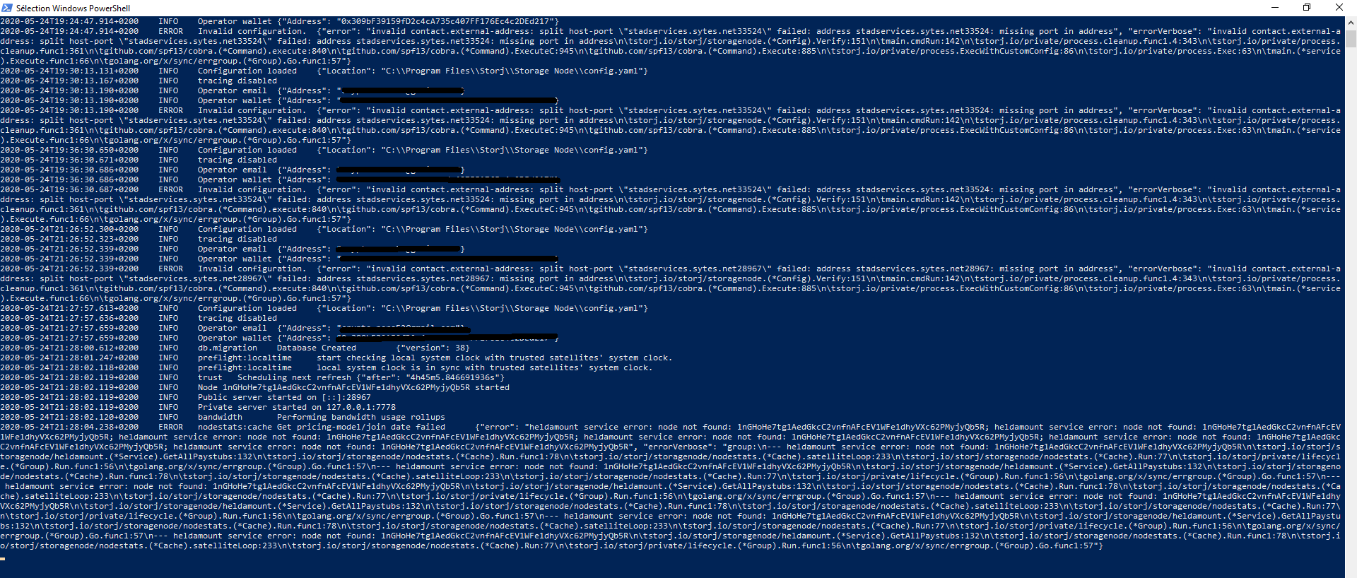

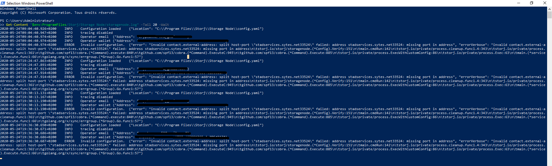

Please, show the last 20 lines from the log: https://documentation.storj.io/resources/faq/check-logs
Hm, could this be related to my port fowarding in the router ?
I’m using “no-ip” of course, my dns is ****services.sytes.net:28967, and i tipped so when installing Storagenode .!
You can edit config.yaml file and contact.external-address should look like
contact.external-address: services.sytes.net:28967
Then restart the storagenode service.
@nerdatwork thank you, now it’s working, I must have made a mistake when typing the address on the installation. Now my status is “Offline” on the dashboard, have i something else to do ?
I checked the logs and i have a “Heldamount service error: node not found : 1nGHoHe7tg1AedGkcC2vnfnAFcEV1WFe1dhyVXc62PMyjyQb5R”.
If you are offline the nodes port is Still closed. Try to find where.
Is your DUC started?
Indeed, beacause i had to enter a different external port in my router, here 33524, i had to enter this port on the config.yaml after my DNS address, now i’m online, thank you all for helping ! :smiley:

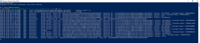

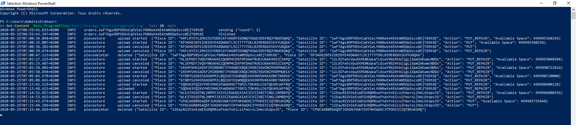

One last question, in my logs i have some “upload canceled”, is this a problem or not ?
It’s not a problem its by design. There are 2 reasons for upload canceled messages.
  1. Your node lost the race for the piece.
  2. Your node didn’t get acknowledgement for the successful upload which is incorrectly shown in the log. A fix for this is in the works.
Make sure you don’t see download failed and GET_AUDIT error messages. Also you should redirect your log to a file else log gets deleted when you restart your node.
