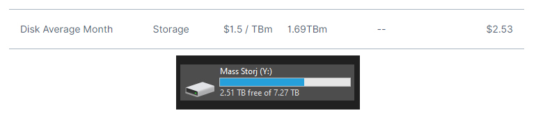

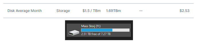

Yeah, that makes sense until I look at my numbers too and I’ve had over 4TB stored from the beginning of the year. I currently have near 5TB stored, yet my Disk Average Month Storage is 1.69TBm. How is this possible and isn’t it calculated as a total accumulated?
This is because it counts storage used so far this month. 4TB stored for half a month would be 2TBm. We’re not halfway through the month yet, so 1.69TBm seems about right.
