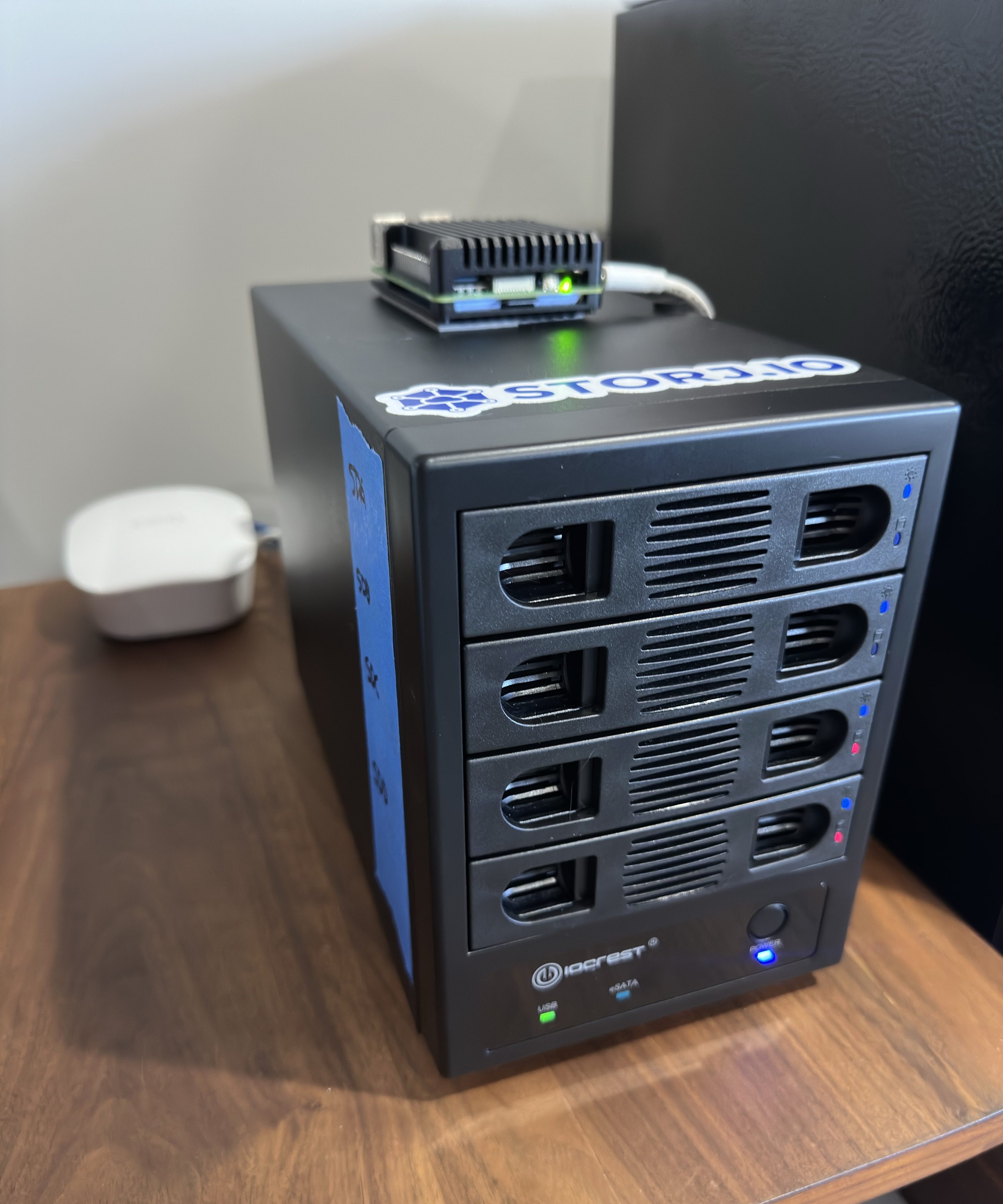

New Pi4(4GB) Build with 2x 16TB and 2x 8TB
This reaction took place after 24 minutes, so 23 minutes later than I expected :joy:
To be fair I already had the 2x8TB drives so some of this was “use what you have”. The 2x16TB second hand drives of which one had 126H of runtime and the other had 5H were good value given size and class of drive. I was using USB docks which I had but wanted a nicer enclosure so I picked this up this 4 bay, again used.
I had debated using some 4TB drives I had on the shelf but rather sent those to another Storjling for their “run what you got” build. Perhaps this offsets a bit of the “run what you got” energy as a fellow Storjling is building two nodes with $0 cost hardware.
Not intending for this to be advice about how or what for others to run rather to share my build.

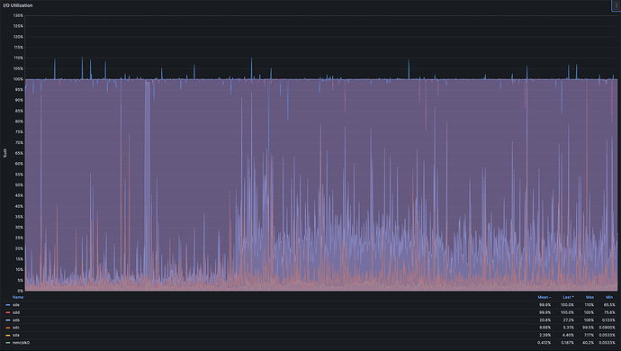

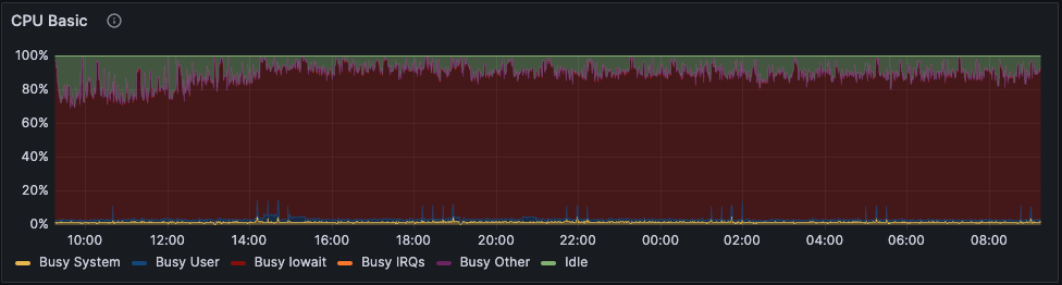

Is this connected via USB or esata? How is iowait/CPU load?
Connected via USB. The 8Tb disks are SMR (I know) and are nearly full so iowait is quite bad. The newer 16TB CMR disks that are working much better. @littleskunk advised I move the databases to a SSD (old one I had in parts bin), this improved performance due to the IO limits of those SMR disks. I’m curious what the IO load looks like after those 8TB drives fill up in a few weeks.
mmcblk0 High Endurance SD Card
sda is SSD with databases and swap
sdb 16TB CMR
sdc 16TB CMR
sdd 8TB SMR (nearly full)
sde 8TB SMR (nearly full)

Nice setup! Cand you show some links for the components, or the model/brand?
I mean for the USB SATA hub, SATA power addapter, power switch.
On my oldest nodes ~4TB give or take after all this time. I can’t say whether that it fast or slow, I’m just using my home Internet connection.
@snorkel I would not advise using USB3 if I was starting from scratch. I’m hoping I can eventually upgrade to SATA, maybe with raspberry pi 5 and some pci-e to SATA board or some used computer chassis.
