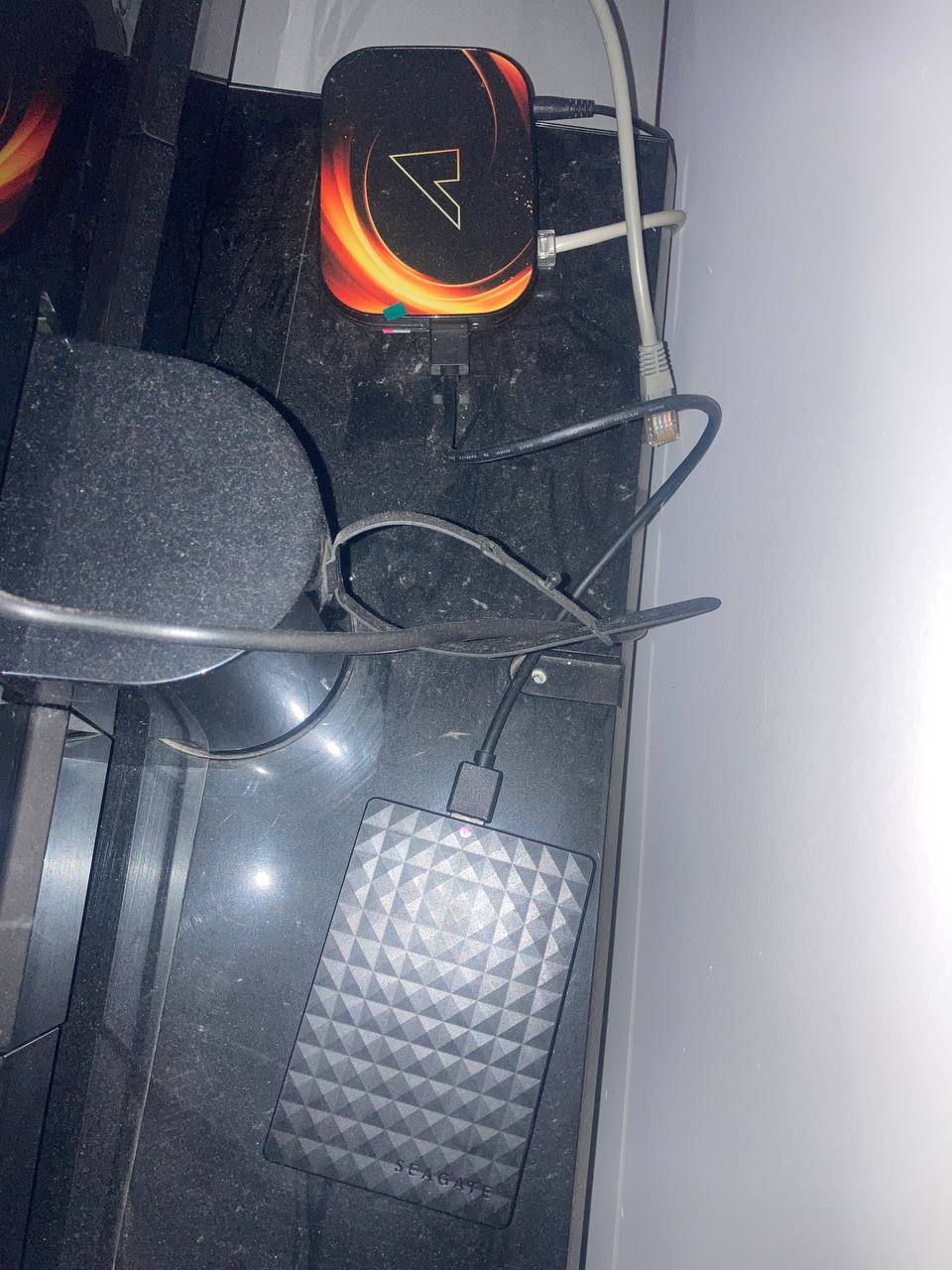

I hide my last node behind the TV. Installed ARMbian linux on the TV BOX and attached 4GB of external HDD.
This could have used ten seconds of dusting and a photo without flash.
Also, probably storj customers after seeing where is their data actually stored:
:scream:
I suggest you to open the case, that hdd can get some better cooling, or it will die soon.
these HDD’s aren’t very longlived anyways. i guess they are all SMR too

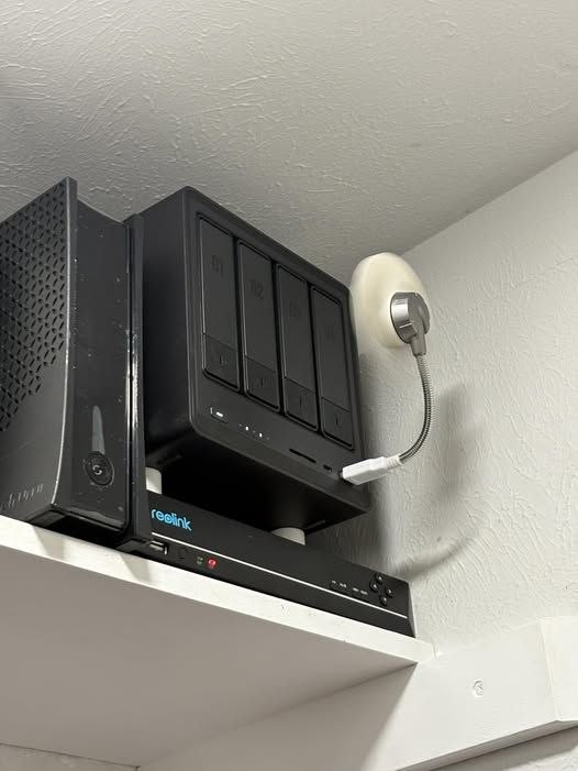

And since the Sun is flexing again, causing the climate change melodrama (not us :wink::shushing_face:), here’s an ideea from X, to use that unused port on your precious node (:grin:):
HEY! I got cake! :face_savoring_food::face_savoring_food::face_savoring_food:
Lol, what a terrible solution.
  • Why does the user want to blow out his USB port. Is he stupid?
  • If cooling is what he wants, why such a dinky fan?
  • Why pot the NAS in the cubby in the first place?
Probably so many other questions to this thing
ELI5: Why is he blowing out his USB port?
