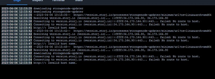

Hello - after trying to move my node to windows gui i must have messed something up. Now i have just tried to boot it normally with docker and i get this error:
I got it Kinda running after reboot but get this error now:
https://pastebin.mozilla.org/kkFnX2Si
serviceping satellite failed
This indicates that your node is not reachable. Maybe you set the wrong ip/port on the docker start?
Currently i can run the node and it seems like data is going in: yet i still have a misc config status in dashboard.
untill it start to fail audits it is OK i think
Thanks Vadim - i hope it just does a full recovery
Please make sure that you provided a correct path. The docker’s node uses data_location/storage
to store data, but Windows GUI node uses data_location
to store its data.
So, for the Windows GUI node you need to provide a data_location\storage
for the data location or move everything from storage
to a parent folder.
Otherwise your node could be disqualified for losing data (because it expects data in a wrong folder…)
Thanks Alexey - that is most likely What i did wrong
