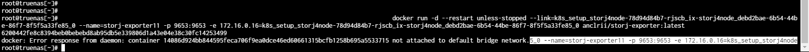

I have a problem with docker instalation of Storj-Exporter. I am using instructions from: https://github.com/anclrii/Storj-Exporter but I’ve got error: "not attached to default bridge network:
Maybe it is a problem that I am using TrueNas and Storj is installed as a docker app and has no own IP only own port…
Please help,
Thanks,
you run it like this
docker run -d --restart unless-stopped
--link=your_storj_docker
--name=storj-exporter
-p 9651:9651
-e STORJ_HOST_ADDRESS=your_storj_docker anclrii/storj-exporter:latest
thanks, I see where I’ve made mistake, but after correcting it I’ve got the same error: "container not attached to default bridge network:
Does anyone have Storj on Truenas Core as Docker App?
You have to literally use this
this is an environment variable and not to be replaced with an ip
still the same
If that is newest scale, there is some issue with contacting source machine via bridge, so may be related.
I didnt checked whats exactly wrong with it, so you need to look it up.

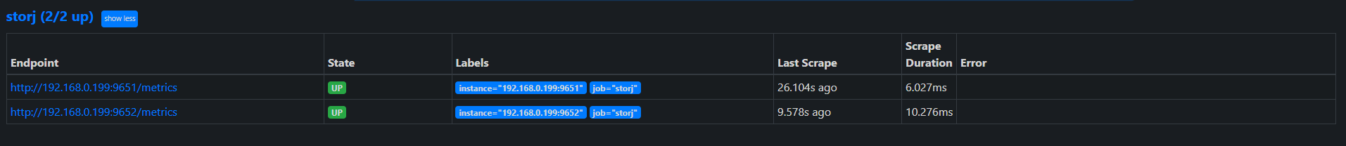

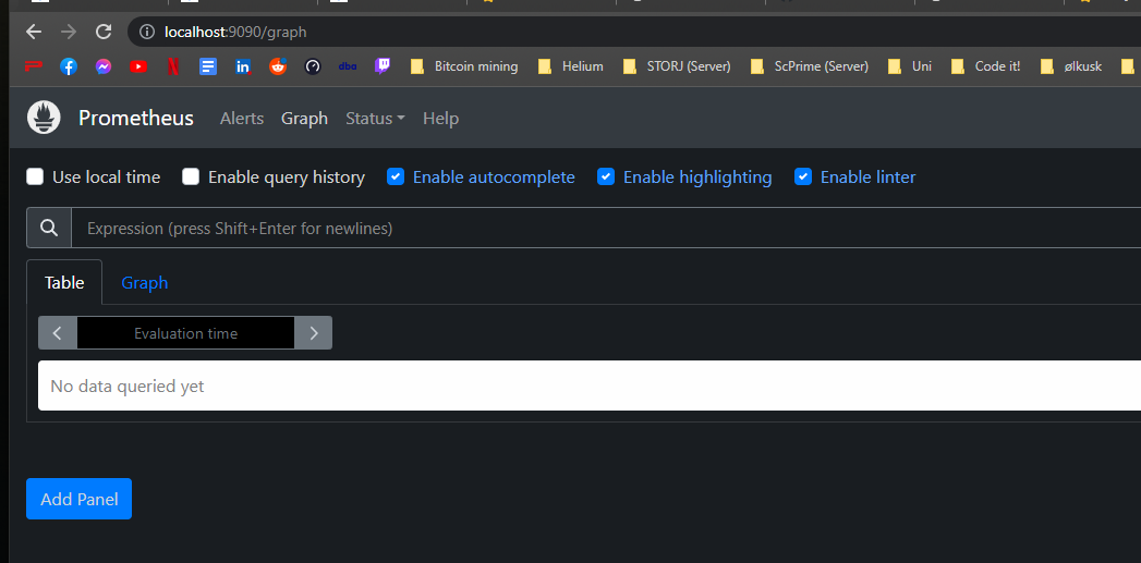

But then looking at Prometheus:
Targets are also there! great.
But looks like some data is not making it to prometheus? ^^^ or am i wrong?

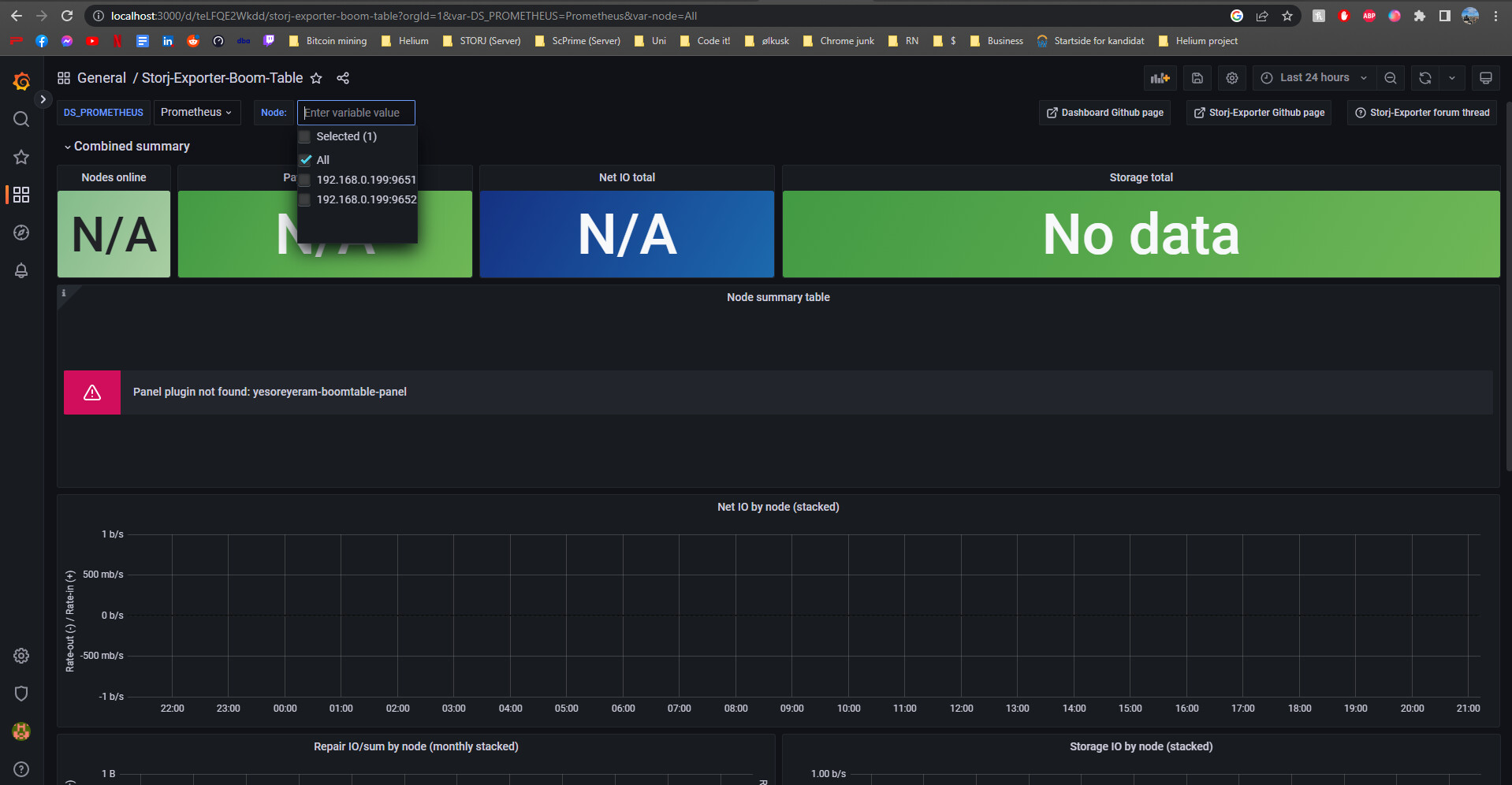

now looking in grafana:
No data is there? but grafana can find the enpoints with my internal ips and ports?
Does anyone have a good answer to why maybe data is going wrong somewhere? Thanks in advance.
Also - all is run in docker on windows. Using the docker compose file.
When you click on explore (the compass icon) do you have data under storj->storj_node_info?
grafik
For me not, I see no data there! Check your exporter docker config :wink:
