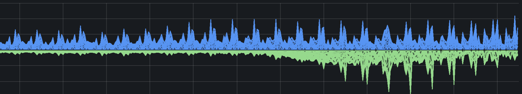

Having also problems with v1.104.5. The Bandwith is not showing correcly per node and the sum of I/O is making spikes:
Here the sum of I/O:
Do you think this can be solved?
These spikes are known to be caused by the latest update to v1.104.5.
The latest update introduced a feature which is bandwidth db caching. Because the storagenode API does not yet refer to the cache to get the latest values for the bandwidth, it means that it only gets an update whenever the cache is flushed to disk, which are those spikes you see.
In addition, as with v1.104.5 only the orders are monitored and not the actual data, keep in mind that the values you will see are only the maximum data you could have uploaded/downloaded if you won all the races. In reality the actual upload/download will be lower than the reported one.
As far as I know, with the current API, there is nothing that the storj exporter can do to resolve these issues (maybe there are different endpoints that could be used?), so its a matter of future updates hopefully fixing the API to refer to cache instead. Not sure what can be done (using the API) to get accurate data unless something is changes in the storagenode software.

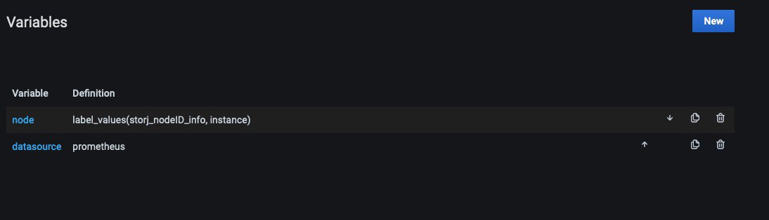

I always have an error about my „Node“-Variable:
IMG_8345
The variable is defined like this:
Someone has experience with this error?
Thx :slight_smile:

These have been fixed, but I think theres an artifact left. When I restart a node, I still get a spike.
Any idea if this is inevitable?
Can confirm that I also get these artifacts with all of my nodes. Currently I do not know any workaround, but judging by some recent commits, I think some changes that are being done for the dedicated disk feature could potentially remove the artifact after restarts. Just a guess.
I just put in grafana to ignore anything larger than 1Gb/s
Could you please explain how to do that for all the graphs? Thanks
add this to the end of the metric browser of the first one, and there is a function to repeat it for the other nodes.
< 80000000
