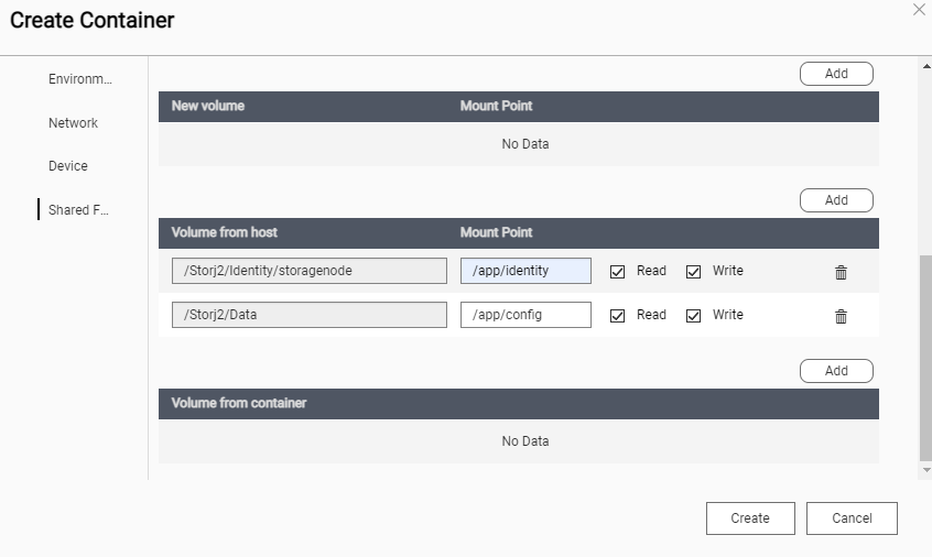

This is the process for install the docker Storj sur QNAP
1- In first delete ALL container Storj Local

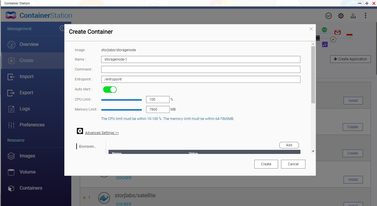

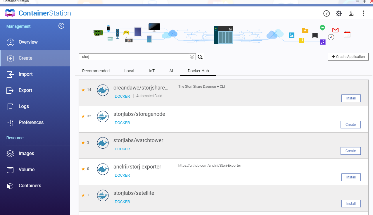

2- Create Docker
you can create STORJLABS/STORAGENODE
replace “/Storj2/” by your folders

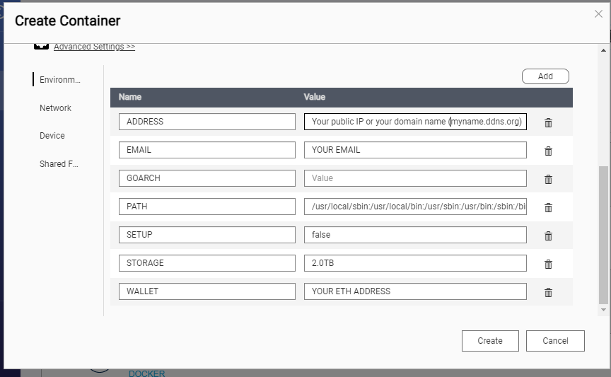

GOARCH is empty
ADDRESS is your IP or your domaine name
you can take yourdomain.ddns.org or yourdomaine.ddns.org:28967 if you have a problem
Click “Create” and go to “OVERVIEW” in Containerstation for start the Docker
