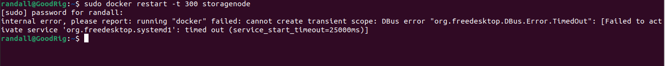

Also get this error message when trying to restart the docker

This suggest to me that your docker installation could be broken. Did you follow their guide? Install Docker Engine on Ubuntu | Docker Docs

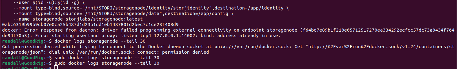

sudo worked…

I went and did the docker engine install like you suggested. I followed the instructions for “install using repository”. Everything looked good and I got the “Hello World” message just fine.
To my utter dismay and unbearable frustration, that actually caused the node to go offline. I stopped it, removed, re-ran the QUIC instructions in STEP 4 and Docker Container download in STEP 6. I then used the same docker run command as before. It says offline and QUIC misconfigured now.
The dashboard loads, and everything looks fine in terminal when running the commands. The logs are giving the same ERROR basically as before but for some reason I am completely offline.

Please post the last 20 lines from your logs after start.
well it went back to being online but misconfigured
What does this mean?
