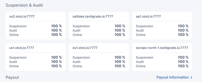

To be clear, it makes sense that a hard refresh changes the QUIC status. You don’t need to restart the node unlike before this change was introduced. We are reusing the contact service which periodically sends a checkin request to the satellite. The satellite then tries to ping back the node via both TCP and QUIC. If any of the satellites fails to ping back the node using QUIC, the dashboard will show the misconfigured status message which could also mean that your node was offline or checkin failed and will be retried or the UDP service port is actually misconfigured.
