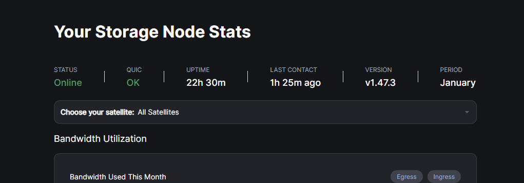

Nope. The node that updated automatically has the same config file as the others and that is currently reporting QUIC as ok.
This one looks perfectly fine so far.
If they both have tcp/udp specified try to restart the one showing miconfigured.

I have the Problem that I can’t open UDP and TCP on the same port on my router. I can only use one port for TCP and a different for UDP. Is there any workaround for that?
Try to clear cache and cookies in the browser for this particular node.
Hello @Deepcuts ,
Welcome to the forum!
Please try to restart the service (or the container, if it’s a docker).
If it’s still shows as misconfigured this is probably true, please check requirements: QUIC requirements - Node Operator
Hello @LamonChan ,
You need to create a second rule for UDP.
Now my node is OK. Problem that i had is that i did not have UDP IPv4 Port forwarding on my home router.
Then run Restart-service storjenode on PowerShell is a must!
Same steps that DrGuns4Hands said:
On my router I could open TCP & UDP with one rule. When creating the rule i have 3 options TCP, UDP or TCP&UDP so maybe you have the same?!
For me, I had to remove some redundant rules from Windows firewall to make it work.
Yes, use the TCP&UDP option for the rule, so it is both together.
thx - that fixed my problem as well!
Hello @Alexey
All my nodes were TCP only.
Noticed the error message about quick and I added the UDP rule also, expecting the node to check again in the near future. None of them did, even after several hours.
Just a simple container restart solved the issue without any other tweaks to command line.
Thus, I stick to my statement: error on storj part.
To me it looks like the node checks QUICK only on startup and if it considers it to be not accesible, it never checks again.
