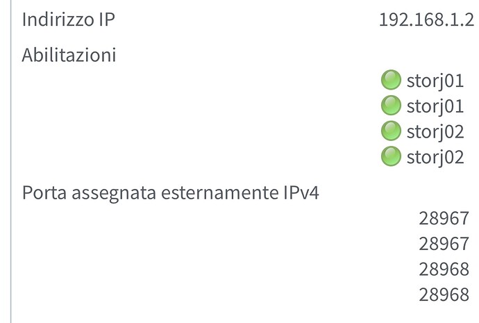

Yes here are my Options
Screenshot 2022-02-01 184407
And if I open UDP on the Same Port as TCP i get the message:
Screenshot 2022-02-02 045829
