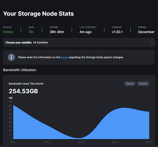

I have a Node on a Pi 2 which runs fine, i simply used the guide for the Pi3
(On 3. Dec the Node was not running because of network issues)
