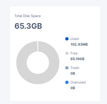

However I see the allocated space in the console to be 64GB while the disk is 2TB and allocated-disk-space is set as:
storage.allocated-disk-space: 1800 GB

Ok, so you are not passing any parameters, and relying on the default location of the config file.
Then yes, your specification shall take effect. However, allocated space wil lbe capped by the actual amount of space on the mountpoint. Many here use this behaviur to dynamically adjust available space: we set 500TB in the config file and adjust quota on the dataset.
SInce you see 65GB but expect more – check where is storage pointing storage.path, and make sure the volume is mounted.
It looks a lot like you have a 65GB system (VM, or jail, or container), with external storage, that failed to mount, so node is seeing local volume.
Thanks, this was very helpful; as you said, the mountpoint was incorrect
