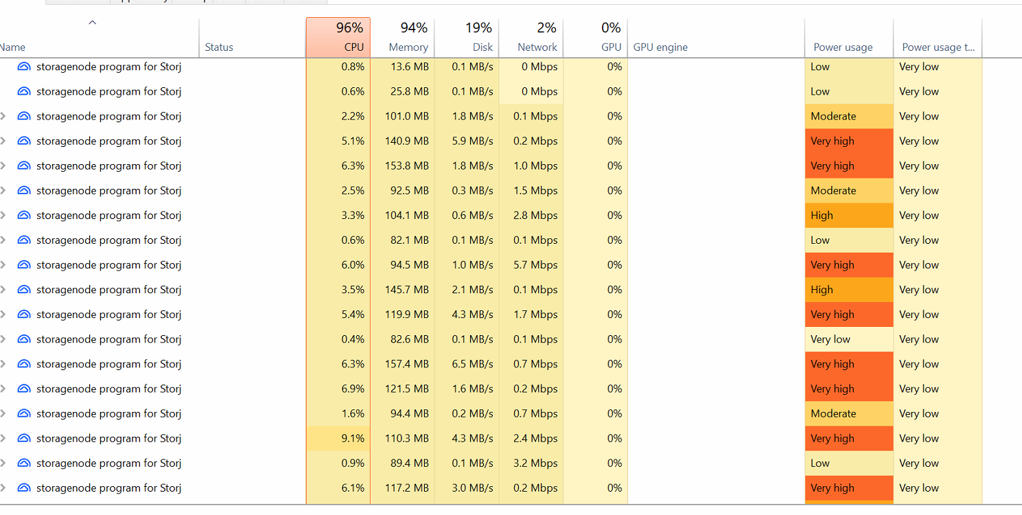

I cant find any of this files specified in this error report
Did you enable memtbl?
No, because this server has only 48GB of RAM
I shared the info with the team.
I downgraded to 1.135 3h ago, now waiting will there be some problems.
1.135.5 is algo go down, without any log, so it is not related to version 1.136
Try move the disk with a failing node to another server to isolate the problem further.
I dont see that any specific device is failing, it like happens with all of them.
If disk failing there is usually no response from hdd in logs, but there is no such. no error at all on the logs.
Could be interesting to move one of the disks to a USB to SATA adapter to see if it is the sata/sas disk controller or cables.
I was able to reproduce this by first creating a situation that would let the node crash and in addition make the log file read only. At that point the service will crash without creating any log entry.
You can still find out whats wrong by stopping the storage node service and try to start it in a cmd promt. In my case it looks like this:

How it will help? My nodes are working, but turn itself off 2-4 times a day without log, why it turns off. when i start it starts OK
cmd would still contain the error even if it can’t be written into the log for what ever reason.
Ok I will try to put one of the nodes like this
After node gone off, cmd just closed.
then please try it run like this:
cmd.exe /c "C:\Program Files\Storj\Storage Node\storagenode.exe" run --config-dir "C:\Program Files\Storj\Storage Node\\"
or run a second cmd.exe in the first one, then execute the run command. This is for the case when the second cmd.exe will be closed, but you will still have all the output in the first one.
Now i somehow got the error, loks like system go out of RAM, server has 48GB, i havent seen in task manager that node consumed over 150MB but i see thna overall is consumed about 45GB when nodes go off, it drops
2025-09-09T16:37:26+03:00 ERROR failure during run {error: Failed to create storage node peer: hashstore: read H:\hashstore\12EayRS2V1kEsWESU9QMRseFhdxYxKicsiFmxrsLZHeLUtdps3S\s0\meta\hashtbl-0000000000000013: Insufficient system resources exist to complete the requested service.\n\tstorj.io/storj/storagenode/hashstore.(*roPageCache).ReadRecord:668\n\tstorj.io/storj/storagenode/hashstore.(*HashTbl).ComputeEstimates:300\n\tstorj.io/storj/storagenode/hashstore.OpenHashTbl:177\n\tstorj.io/storj/storagenode/hashstore.OpenTable:146\n\tstorj.io/storj/storagenode/hashstore.NewStore:276\n\tstorj.io/storj/storagenode/hashstore.New:93\n\tstorj.io/storj/storagenode/piecestore.(*HashStoreBackend).getDB:248\n\tstorj.io/storj/storagenode/piecestore.NewHashStoreBackend:114\n\tstorj.io/storj/storagenode.New:618\n\tmain.cmdRun:84\n\tmain.newRunCmd.func1:33\n\tstorj.io/common/process.cleanup.func1.2:388\n\tstorj.io/common/process.cleanup.func1:406\n\tgithub.com/spf13/cobra.(*Command).execute:985\n\tgithub.com/spf13/cobra.(*Command).ExecuteC:1117\n\tgithub.com/spf13/cobra.(*Command).Execute:1041\n\tstorj.io/common/process.ExecWithCustomOptions:115\n\tstorj.io/common/process.ExecWithCustomConfigAndLogger:80\n\tstorj.io/common/process.ExecWithCustomConfig:75\n\tstorj.io/common/process.Exec:65\n\tmain.(*service).Execute.func1:107\n\tgolang.org/x/sync/errgroup.(*Group).add.func1:130, errorVerbose: Failed to create storage node peer: hashstore: read H:\hashstore\12EayRS2V1kEsWESU9QMRseFhdxYxKicsiFmxrsLZHeLUtdps3S\s0\meta\hashtbl-0000000000000013: Insufficient system resources exist to complete the requested service.\n\tstorj.io/storj/storagenode/hashstore.(*roPageCache).ReadRecord:668\n\tstorj.io/storj/storagenode/hashstore.(*HashTbl).ComputeEstimates:300\n\tstorj.io/storj/storagenode/hashstore.OpenHashTbl:177\n\tstorj.io/storj/storagenode/hashstore.OpenTable:146\n\tstorj.io/storj/storagenode/hashstore.NewStore:276\n\tstorj.io/storj/storagenode/hashstore.New:93\n\tstorj.io/storj/storagenode/piecestore.(*HashStoreBackend).getDB:248\n\tstorj.io/storj/storagenode/piecestore.NewHashStoreBackend:114\n\tstorj.io/storj/storagenode.New:618\n\tmain.cmdRun:84\n\tmain.newRunCmd.func1:33\n\tstorj.io/common/process.cleanup.func1.2:388\n\tstorj.io/common/process.cleanup.func1:406\n\tgithub.com/spf13/cobra.(*Command).execute:985\n\tgithub.com/spf13/cobra.(*Command).ExecuteC:1117\n\tgithub.com/spf13/cobra.(*Command).Execute:1041\n\tstorj.io/common/process.ExecWithCustomOptions:115\n\tstorj.io/common/process.ExecWithCustomConfigAndLogger:80\n\tstorj.io/common/process.ExecWithCustomConfig:75\n\tstorj.io/common/process.Exec:65\n\tmain.(*service).Execute.func1:107\n\tgolang.org/x/sync/errgroup.(*Group).add.func1:130\n\tmain.cmdRun:86\n\tmain.newRunCmd.func1:33\n\tstorj.io/common/process.cleanup.func1.2:388\n\tstorj.io/common/process.cleanup.func1:406\n\tgithub.com/spf13/cobra.(*Command).execute:985\n\tgithub.com/spf13/cobra.(*Command).ExecuteC:1117\n\tgithub.com/spf13/cobra.(*Command).Execute:1041\n\tstorj.io/common/process.ExecWithCustomOptions:115\n\tstorj.io/common/process.ExecWithCustomConfigAndLogger:80\n\tstorj.io/common/process.ExecWithCustomConfig:75\n\tstorj.io/common/process.Exec:65\n\tmain.(*service).Execute.func1:107\n\tgolang.org/x/sync/errgroup.(*Group).add.func1:130}
2025-09-09T16:37:26+03:00 FATAL Unrecoverable error {error: Failed to create storage node peer: hashstore: read H:\hashstore\12EayRS2V1kEsWESU9QMRseFhdxYxKicsiFmxrsLZHeLUtdps3S\s0\meta\hashtbl-0000000000000013: Insufficient system resources exist to complete the requested service.\n\tstorj.io/storj/storagenode/hashstore.(*roPageCache).ReadRecord:668\n\tstorj.io/storj/storagenode/hashstore.(*HashTbl).ComputeEstimates:300\n\tstorj.io/storj/storagenode/hashstore.OpenHashTbl:177\n\tstorj.io/storj/storagenode/hashstore.OpenTable:146\n\tstorj.io/storj/storagenode/hashstore.NewStore:276\n\tstorj.io/storj/storagenode/hashstore.New:93\n\tstorj.io/storj/storagenode/piecestore.(*HashStoreBackend).getDB:248\n\tstorj.io/storj/storagenode/piecestore.NewHashStoreBackend:114\n\tstorj.io/storj/storagenode.New:618\n\tmain.cmdRun:84\n\tmain.newRunCmd.func1:33\n\tstorj.io/common/process.cleanup.func1.2:388\n\tstorj.io/common/process.cleanup.func1:406\n\tgithub.com/spf13/cobra.(*Command).execute:985\n\tgithub.com/spf13/cobra.(*Command).ExecuteC:1117\n\tgithub.com/spf13/cobra.(*Command).Execute:1041\n\tstorj.io/common/process.ExecWithCustomOptions:115\n\tstorj.io/common/process.ExecWithCustomConfigAndLogger:80\n\tstorj.io/common/process.ExecWithCustomConfig:75\n\tstorj.io/common/process.Exec:65\n\tmain.(*service).Execute.func1:107\n\tgolang.org/x/sync/errgroup.(*Group).add.func1:130, errorVerbose: Failed to create storage node peer: hashstore: read H:\hashstore\12EayRS2V1kEsWESU9QMRseFhdxYxKicsiFmxrsLZHeLUtdps3S\s0\meta\hashtbl-0000000000000013: Insufficient system resources exist to complete the requested service.\n\tstorj.io/storj/storagenode/hashstore.(*roPageCache).ReadRecord:668\n\tstorj.io/storj/storagenode/hashstore.(*HashTbl).ComputeEstimates:300\n\tstorj.io/storj/storagenode/hashstore.OpenHashTbl:177\n\tstorj.io/storj/storagenode/hashstore.OpenTable:146\n\tstorj.io/storj/storagenode/hashstore.NewStore:276\n\tstorj.io/storj/storagenode/hashstore.New:93\n\tstorj.io/storj/storagenode/piecestore.(*HashStoreBackend).getDB:248\n\tstorj.io/storj/storagenode/piecestore.NewHashStoreBackend:114\n\tstorj.io/storj/storagenode.New:618\n\tmain.cmdRun:84\n\tmain.newRunCmd.func1:33\n\tstorj.io/common/process.cleanup.func1.2:388\n\tstorj.io/common/process.cleanup.func1:406\n\tgithub.com/spf13/cobra.(*Command).execute:985\n\tgithub.com/spf13/cobra.(*Command).ExecuteC:1117\n\tgithub.com/spf13/cobra.(*Command).Execute:1041\n\tstorj.io/common/process.ExecWithCustomOptions:115\n\tstorj.io/common/process.ExecWithCustomConfigAndLogger:80\n\tstorj.io/common/process.ExecWithCustomConfig:75\n\tstorj.io/common/process.Exec:65\n\tmain.(*service).Execute.func1:107\n\tgolang.org/x/sync/errgroup.(*Group).add.func1:130\n\tmain.cmdRun:86\n\tmain.newRunCmd.func1:33\n\tstorj.io/common/process.cleanup.func1.2:388\n\tstorj.io/common/process.cleanup.func1:406\n\tgithub.com/spf13/cobra.(*Command).execute:985\n\tgithub.com/spf13/cobra.(*Command).ExecuteC:1117\n\tgithub.com/spf13/cobra.(*Command).Execute:1041\n\tstorj.io/common/process.ExecWithCustomOptions:115\n\tstorj.io/common/process.ExecWithCustomConfigAndLogger:80\n\tstorj.io/common/process.ExecWithCustomConfig:75\n\tstorj.io/common/process.Exec:65\n\tmain.(*service).Execute.func1:107\n\tgolang.org/x/sync/errgroup.(*Group).add.func1:130}
Did you integrated some Miner to storagenode?
cpu is I7-12700k 128GB RAM
Iti is not that server that gives problems now, this yet works OK
server run only Storj with 17 nodes
For my windows server systems memory usage with hashstore looking strange as well. Almost all physical memory in use and huge pagefile but nodes still running. This is a big difference compared to my linux systems where everything looking nice.
do you use memtbl or standart hashstore?
