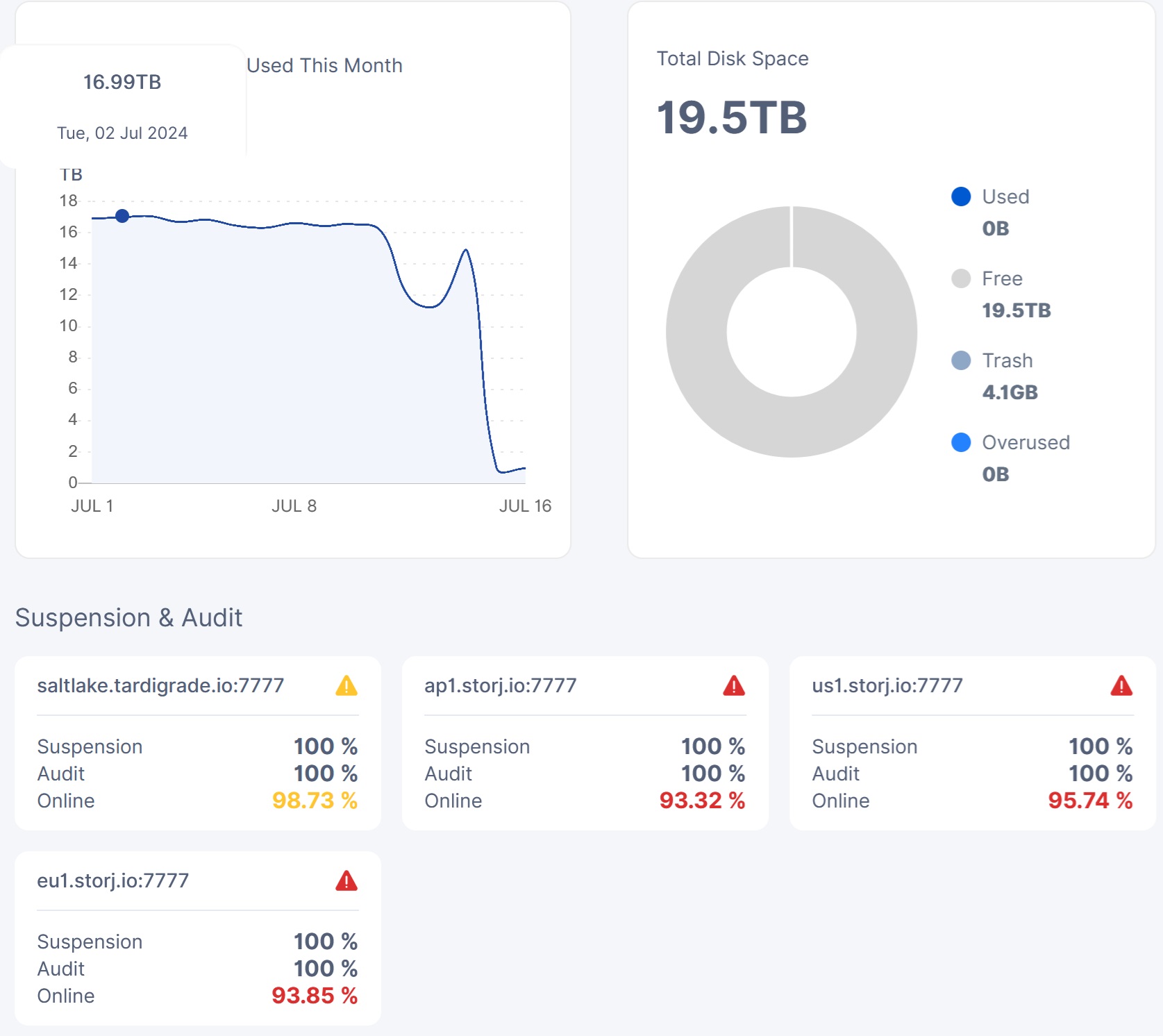

I am again unable to access the node dashboard. Have had no internet downtime (all other nodes show continual uptime).
Command pulls the following with ERROR showing failed to start subprocess

support26:
2024-07-15T13:14:11-04:00 INFO lazyfilewalker.used-space-filewalker subprocess exited with status {"satelliteID": "1wFTAgs9DP5RSnCqKV1eLf6N9wtk4EAtmN5DpSxcs8EjT69tGE", "status": 1, "error": "exit status 1"}
The lazy filewalker is failed due to insufficient IOPS from the disk. However, it should not crash the node. But this could be also a consequence of the node crash due to other reason, like a FATAL or an Unrecoverable error.
Do you see the error like this one: Fatal Error on my Node ?
Alexey:
Something is - the dashboard looks like this now
No Fatal Error on my Node.
