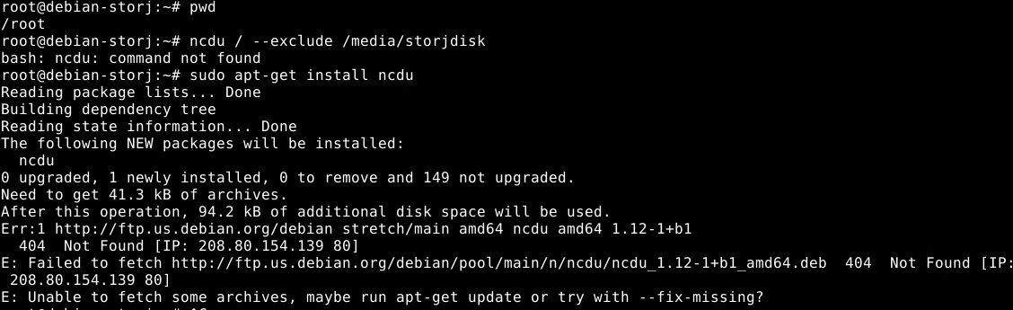

Not sure it installed, but if it did, what command(s) do I run?
you can run this command:
ncdu / --exclude /media/storjdisk
run ncdu on root dir, except this dir /media/storjdisk
P/s: a better command would be
ncdu -x /
Thanks to @Toyoo
I see you are using stretch, I don’t have experience in runing such old distro, you can:
- download deb and install it manually https://pkgs.org/download/ncdu
- (not recommend but it possible) try to change your source.list file to buster and update and install it - install only ncdu - and then change source.list back to stretch.
P/s: the reason it not working is because ftp.us.debian.org don’t support it anymore, maybe some other mirror could still (see this Debian version history - Wikipedia - freexian still support them - but I’ve no idea - good luck).
