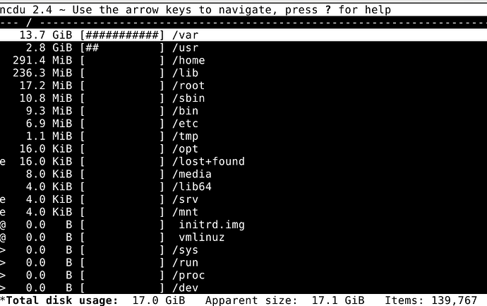

Thanks for the info, silly me, you can download static binary from the creator himself NCurses Disk Usage
Try these command:
cd /tmp
wget https://dev.yorhel.nl/download/ncdu-2.4-linux-x86_64.tar.gz
tar -xvf ncdu-2.4-linux-x86_64.tar.gz
./ncdu -x /

I let it run for 30 mins and it returned nothing so i ctl+c’d it. I can try again today and just let it run while I work

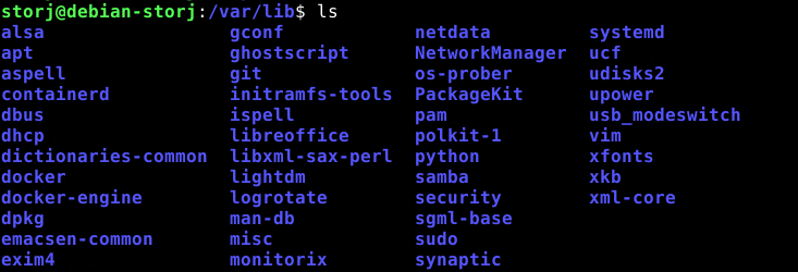

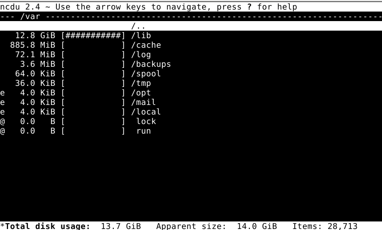

I’m done my job here, you go into /var/lib and see what take space that you could save here, good luck!
If you use ncdu now, no need to run it again.
But I think it is clear now where your space went.

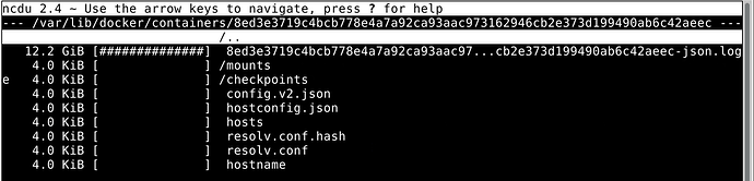

Ran it again on /var/lib and it says /docker/containers is the 12GB
Drilled in there and it is the xxxxx-json.log
Can I clean that up without impacting my node?
@Alexey Is this now the part where I stop the node, change the log location, purge the dockers, and then set it up to auto delete the logs?
@Alexey Now that we have identified that it is the Storj log file in the docker folder that is very large. Is there a way to purge those logs?
I have stopped, removed, and started the node several time in the past couple months yet the log file is still massive (prob holding 5 years worth of logs or something).
Can you look with “tail” what the last lines of the log file are? Maybe it’s not the one currently in use and rather from an old image. Then follow this to prune dangling images
If it’s the currently used log file, then empty it with “echo > /path/to/logfile”
