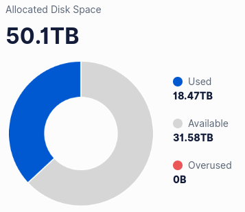

As I’ve been entertaining myself with reading the restructuring threads tonight, a recurring question occurs to me. How do SNOs end up with hundreds of TB of data? I’ve been stuck at ~35% utilization for literally years. I have low latency 500/500 fiber internet, but only a single IP address. I would have expanded if my disks filled, but they just sit. Are my results really because my 9 nodes are behind a single IP address?

Of course. They are treated as 1 node.
By openly working around /24 rule and hosting a swarm of nodes on an industrial strength server farm:
Sure, of course, I understand. Does everyone show ~35% utilization? If the network was evenly distributed across every /24 with nodes of reasonable performance, we’d all show the same utilization?
Utilization will depend on the allocated size. Currently node levels out at 10-12TB – deletions balance out additions at about that size.

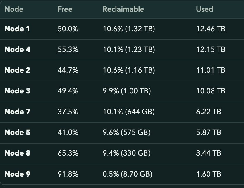

Sorted by size:
  • The Node1 was created in 2022 (cable internet).
  • Node4 – 2024 (symmetric fiber).
  • Node 9 - early 2026 (also cable internet)
The 12TB seems to be a saturation point
Did you use a one connection channel?
Because if not, then it’s a normal distribution, I guess?
No, all except 2 and 9 are on the different hosts in different cities. 2 and 9 are on the same host/same IP.
Actually 2 and 9 also add up to 12! Nice!
Yes, I’m not saying it’s abnormal :). Works as designed.
