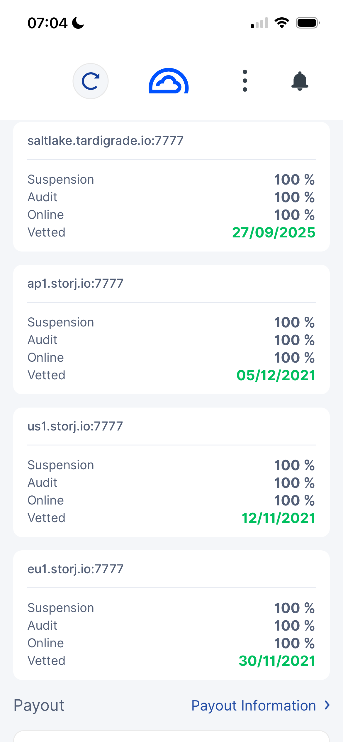

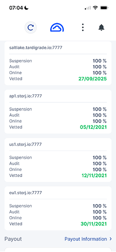

That’s suddenly looking a lot better on my nodes
Saltlake has just jumped to 100% Online Status - on all of my nodes.
Not only Saltlake, but also the other satellites, I had nodes stuck at 92% for a month and as if by magic this morning I find almost everything 100% online

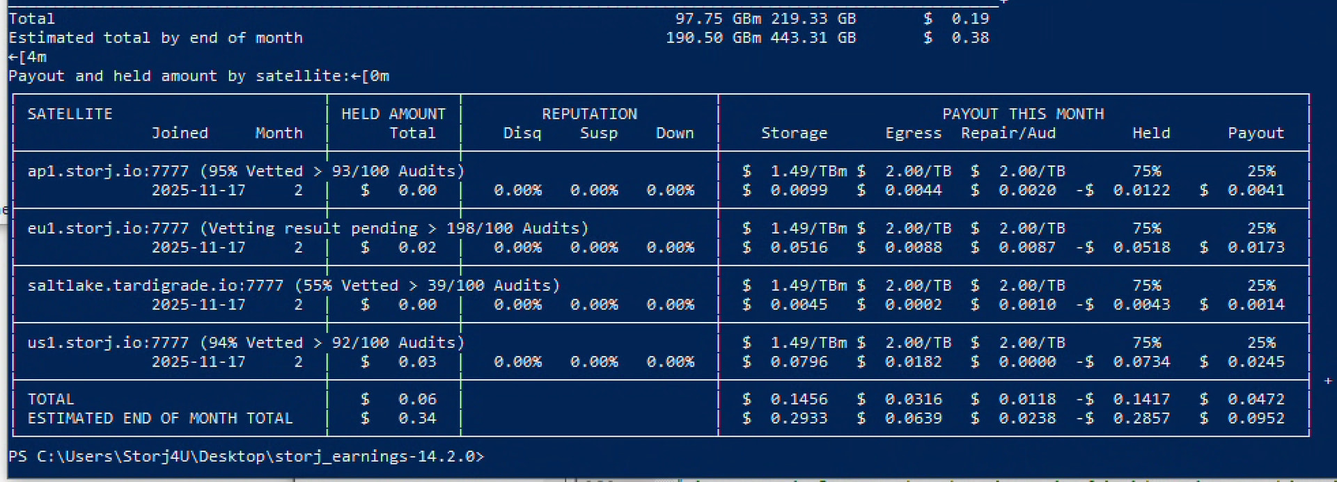

I see on eu: Vetting result pending
Meaning it has all audits but is still only geting 1% traffic - seems off? :smiley:

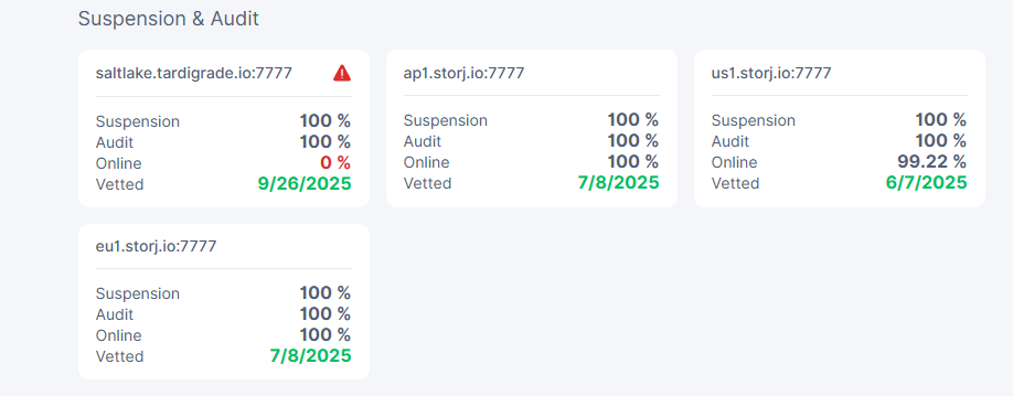

My saltlake node dropped from 100% to 0% in 1 day.

Now it’s not bound to 100 audits, it’s dynamic. The goal is the same - vetting should be not less than a month.
See

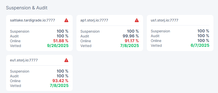

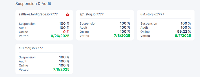

Online Score is weird, screenshotted same day. Saltlake drop from 100 to 0 then now is 51. others drop while my node was online. The audit score dropped 0.04% as well on ap1.
This may indicate data loss.
Nothing to worry about.at 0.04% (It’s an issue if it gets down to 96%) it will be back up in a couple of days (provided Audits continue to work)
Saltlake does strange things sometimes.

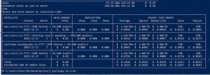

Wasn’t aware of that. Thanks for letting us know. Working on an update for the earnings calculator to incorporate this so nodes don’t say “Vetting results pending” for weeks, but instead display the lowest value between vetting progress based on counts and vetting progress based on time. I asked in the topic you linked whether the release defaults of 100 audits and 504 hours are being used, but since they usually are I might release the new version before confirmation. (Can always fix it later)
@HGPlays don’t worry about seeing vetting result pending in the current version. I have to derive it based on what the node knows and it isn’t aware of the exact conditions required to be vetted, so I have to manually add those conditions in the calculator. New version will show a percentage that reflects both conditions.
