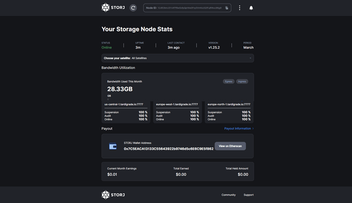

Hello, I wonder if there is something wrong in my configuration or I’m missing some point: i’ve launched the node a week-ish ago and looks like i’m not getting a consistent usage?
But everything looks fine on my side:
Your image shows no bandwidth usage information. Although, this is a common “new” topic created on this forum by new node operators. There appears to be quite a misconception by many new node operators that 1) bandwidth usage has any sort of consistency and 2) that you’ll start seeing high usage immediately.
You’re node is so young that I wouldn’t expect you to have much bandwidth usage after only a week. After you get through the vetting period on each satellite, you should expect to start seeing higher ingress rates.

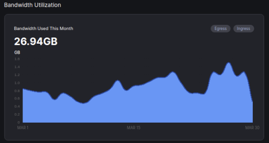

Here’s an example of a bandwidth utilization graph for this month from one of the two nodes I started in February:
And just for reference, 25.41 GB of that bandwidth usage is ingress. Only 1.53 GB of egress since it’s still so new and is only vetted on 1 of 5 satellites.
Everyone’s nodes will see that variation on a day to day basis. Bottom line: there’s no consistency or predictability.

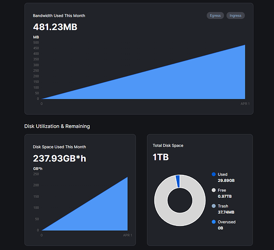

Ahh haven’t noticed Snagit cut it off… thought he took the whole screen. That’s the actual but month just started… how to see a previous month?
Unfortunately that’s not possible.
ah ok welll… let’s sit and wait :smiley:
