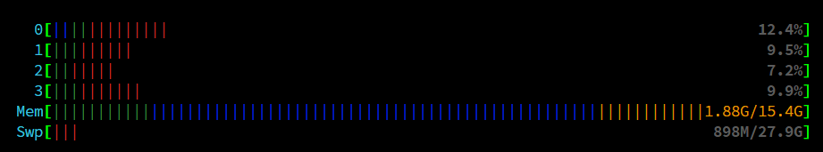

How much RAM does this NUC have ?
Yeah I’d grep dmesg or /var/log/syslog (or whereever system messages are for your distro) for “oom” messages.
RAM Memory is 16GB, almost 2GB being used, I don’t think it’s the computer, because I have another storagenode running in the same machine, but different HDD, and is doing good.
