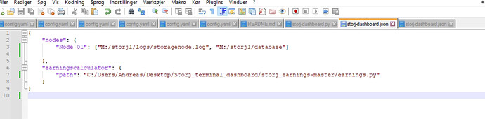

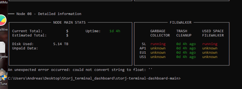

i gave it another go:
still seems there is issues or maybe im doing something wrong.
The only real question remaining so far for me is who will eventually win in the battle of the author vs this code:
The code is winning with the score 3:0 so far.

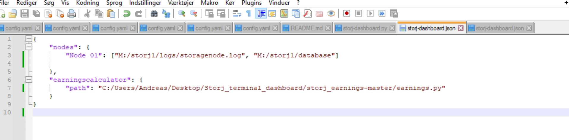

Yeah, your config still has the path to the log file itself in it. You need to change it to the directory of the logs instead.
In your case you need to change
Node 01: [M:/storj1/logs/storagenode.log", "M/storj1/database"]
to
Node 01: [M:/storj1/logs/", "M/storj1/database"]

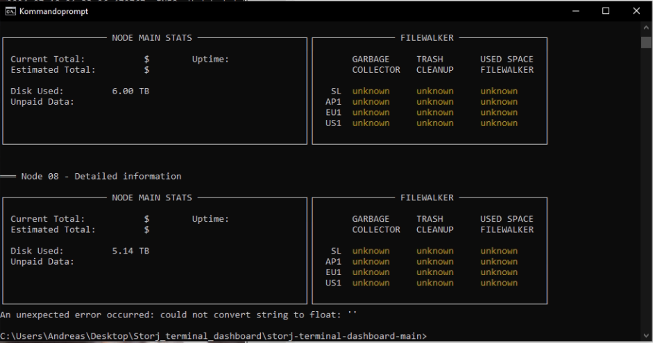

I also suspect, that the earnings calculator is still not parsed correctly. I added some additional error logging in the most recent version. Please update and send new screenshots.

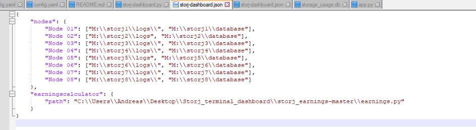

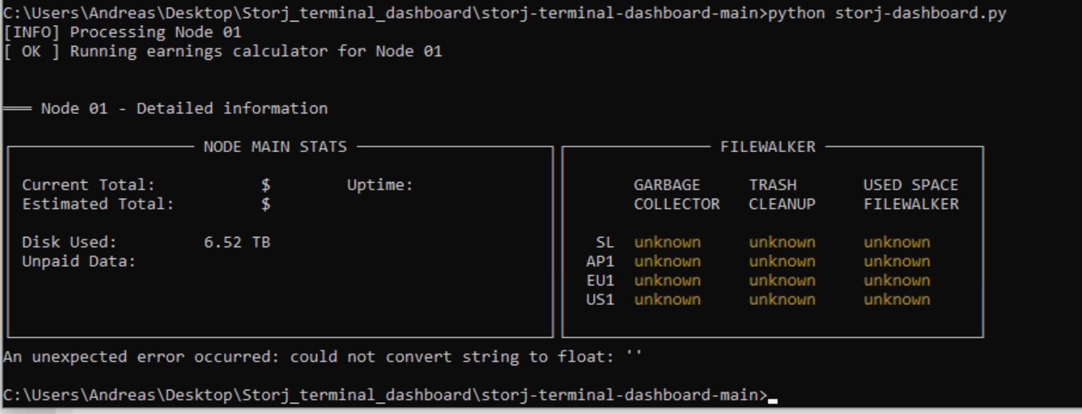

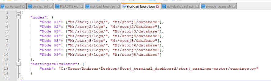

new try:
cmd:
Why all your route deviders are / windows use \ in path
in json I mean.
I Will try that :slight_smile:
More Words

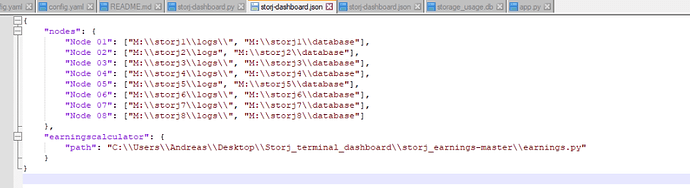

i dont belive this was the cause - if i change to \ i get errors in the script.
Then you likely need to use \\ instead…
Thanks - will try :smiley:
more words

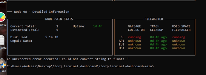

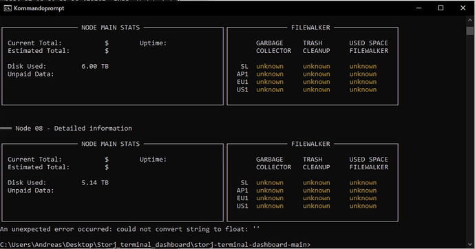

its getting better but still not working fully.
It doesnt appear to recognize the filewalker anymore. I have a node that its definitely running, but the dashboard shows 0 running. Any info I can provide to help? GC and TC are recognized.
