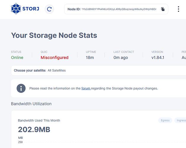

Removed old configuration file and node installed and started/ Only one question left port forward/ I configured it on my Fortigate and see traffic according to forward rule
but QUIC misconfigured message still appear
The issue was solved by adding a rule for UDP on local FW - for TCP rule was created automatically during installation but UDP
