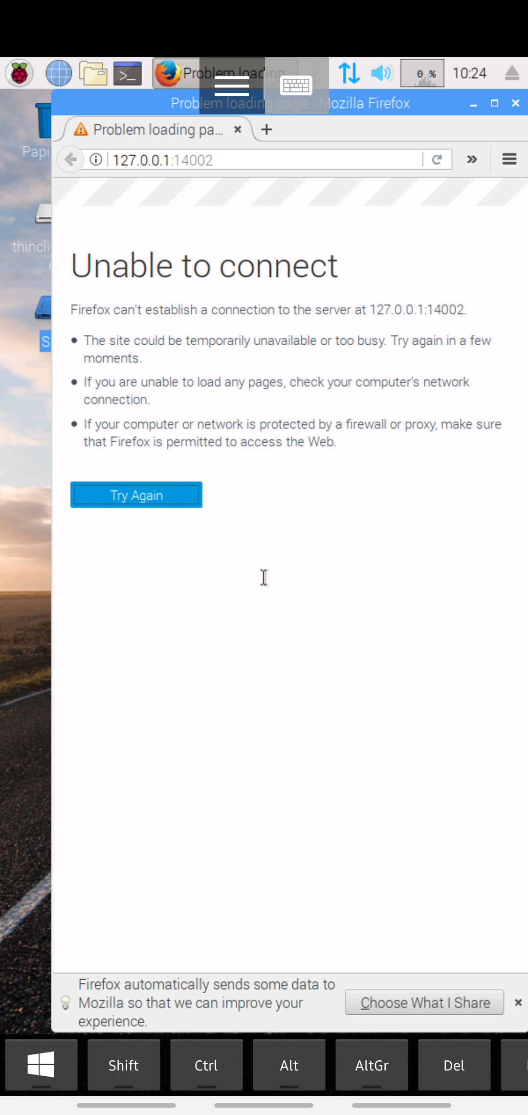

When I go to my dashboard it will look like the picture.
What can I do?
The screenshot looks like they’re trying to access their node from a mobile device.
The first thing to check is whether port 14002 is properly open on the Internet provider router.
This said, in my case it does not support the ‘back loop’ feature, which means that I personnally can use the Ddns address from outside my house (e.g. my-addr.ddns.net:14002) whereas I do have to use my node’s local address when at home, connected to my box (e.g. 192.168.1.3:14002).

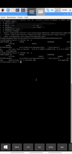

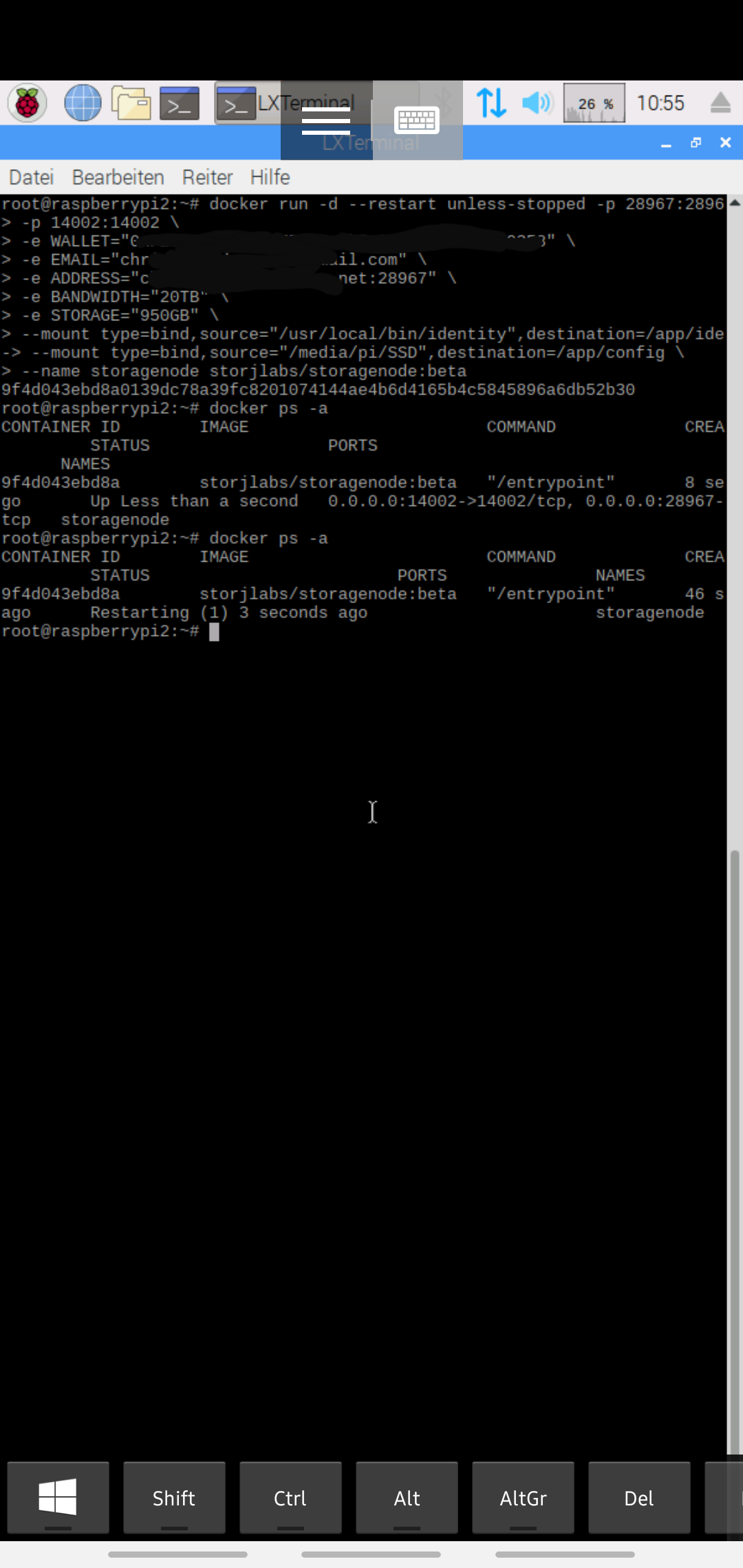

Maybe share with us the command you used to start your node, after removing personal data (email, wallet address, …).

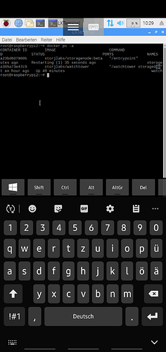

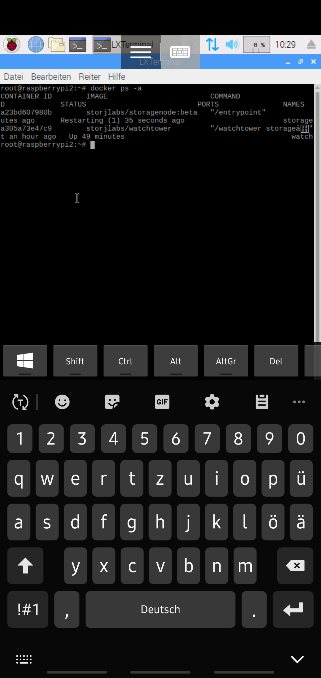

Also, would be usefull to check whether your node’s up and running with ‘docker ps -a’.
Maybe check the node’s logs too.
The “restarting (1) 35 seconds ago” status doesn’t look good, I guess the container cannot manage to start properly.
Does this container output some logs?
What do you mean
How can I do that it doesnt restart.
My guess is that it keeps restarting, so maybe it outputs some useful logs at every attempt, before exiting?

Something like this:
docker logs --tail 30 storagenode
I think i must open it manual but wich should i open?
I’m not sure what you mean.
Considering you node has been named ‘storagenode’, doesn’t the ‘docker logs’ command above give some results?

It’s not recommended to open the dashboard to the internet.
