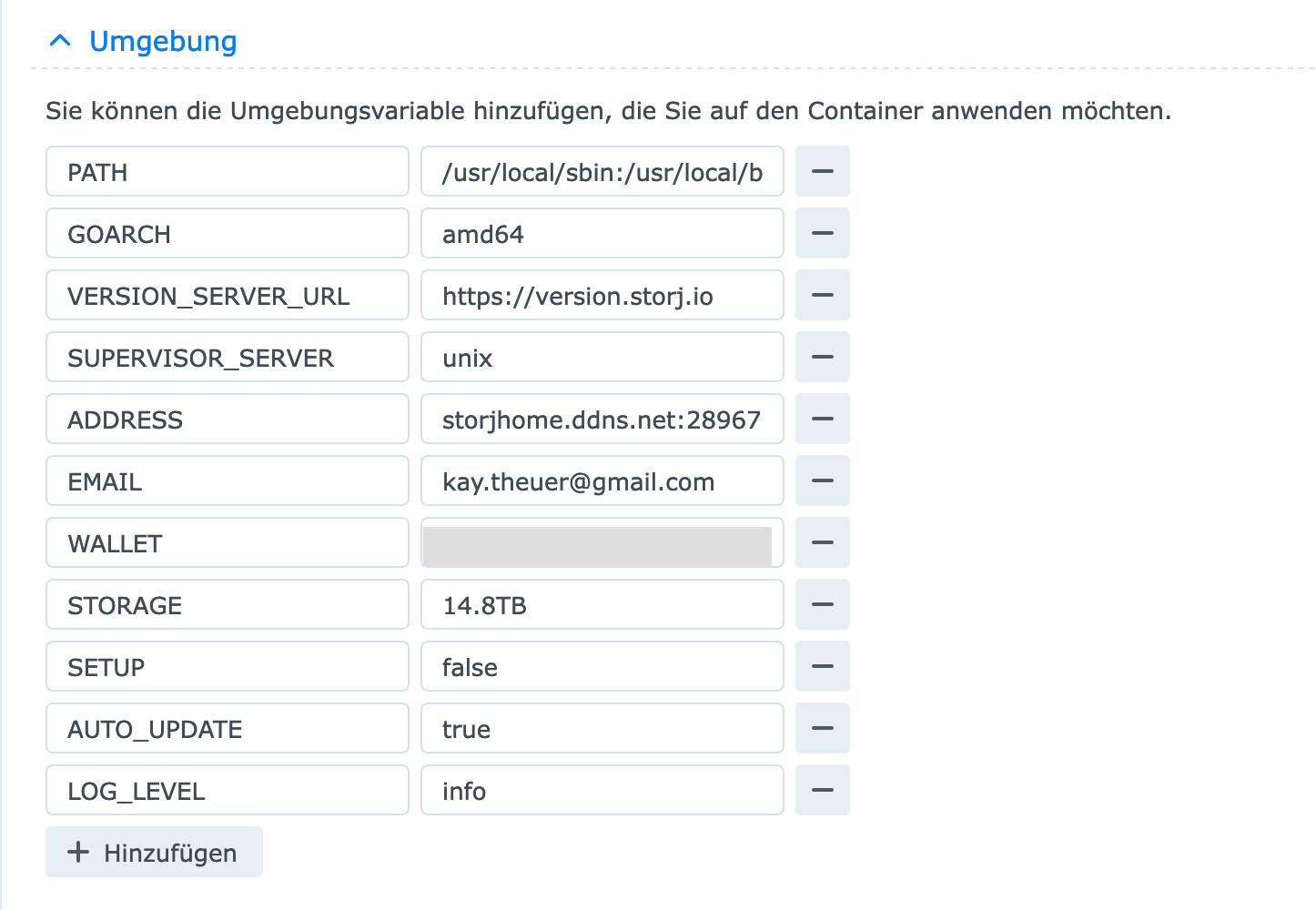

These are the settings in the Docker on the Synology.

Try:
STORAGE 14800GB
Thank you, it did not bring any change.
The following message appeared:
Error: invalid argument “Wert” for “–log.level” flag: unrecognized level: “Wert”
I have the value “info” here - which one should go in here?

makes me think, that you used wrong symbols somewhere, like using curly quotes “ and ” instead of correct straight quotes ".
ideally you shouldn’t specify this variable at all, but yes, it’s info by default.
