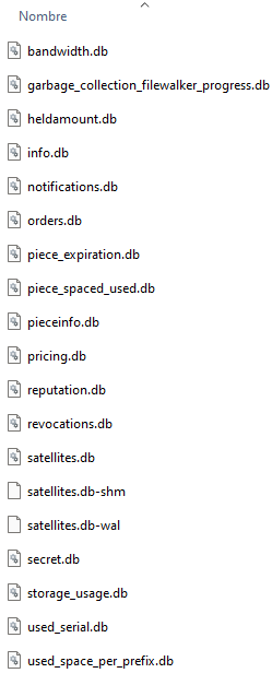

When i had this problem, only fix that helped, i deleted databases and catch.
Which ones would you delete? (I understand that it’s not necessary to delete all of them.)
First i moved all of them. Then starded new ones. then stop node and copied all back exept storage_used and used_space_per_prefix
Thanks so much @Vadim, the data is coming back. Now I just need to run the scan and get everything back in order.
