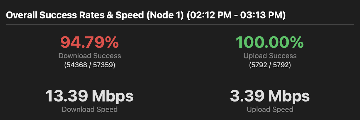

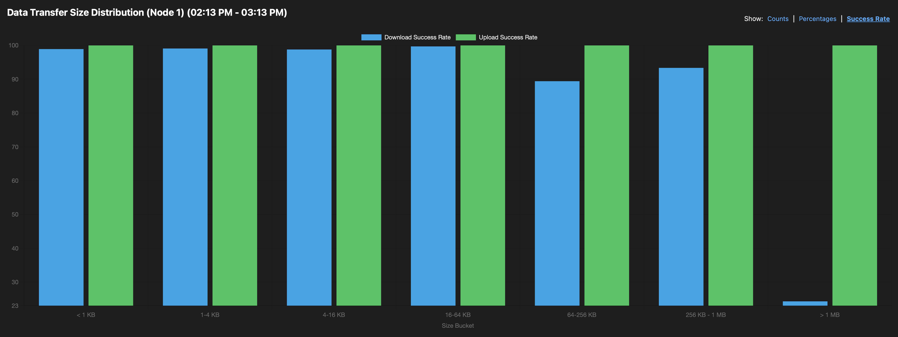

I have cable internet with 35Mbps upstream bandwidth, which with the recent spike in egress is being saturated at 50Mbps, ramping up latency to 60ms.
Success rates looks quite sad:
Just look at the large files success rate -- under 25%!

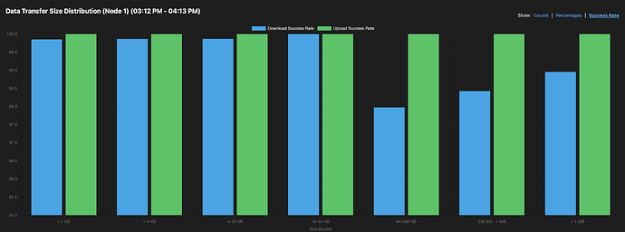

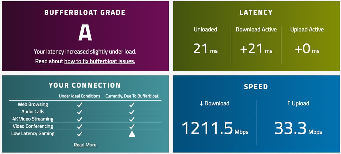

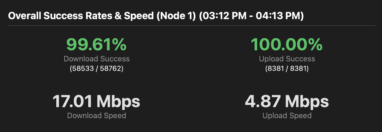

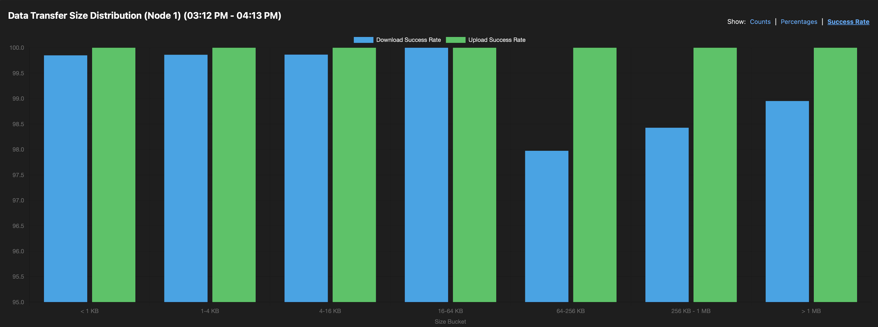

Enabling SQM with 40Mbps limiter drops latency to 15ms while still saturated, albeit at lower throughput:
And the success rate on large files is magnificent now as well! (note scale is now different
Not only success rate is higher, but effective throughput also increased, overall internet browsing speed increased, and everything feels more responsive, while consuming less bandwidth. Because the pipe isn’t bogged down by nonsense.
