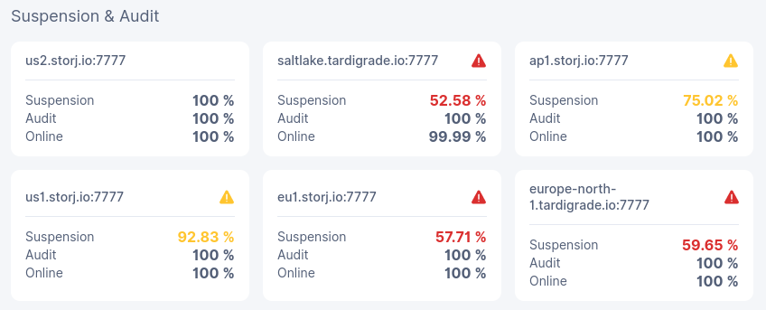

Facing the issue on 3 different node sthat the suspension is going down. One node even got suspended. Not sure if this is related to v1.47.3. Interesting is also that us is still 100%. What can I do?
Restarted the node and now it seems that the numbers are recovering. No idea what is happening with it.
Could not working QUIC be the issue? Configured it to work on all nodes now…
No.
The suspension score is falling when something wrong with pieces.
Please, check for the reasons: https://support.storj.io/hc/en-us/articles/360042257912-Suspension-mode
Ok, looks like this was a temporary Problem. This means that the suspension value should recover again over time and my node will get unsuspended at some point?

If the problem is fixed, the suspension score will recover with each successful audit and GET_REPAIR.
Looking on your errors I see a network issue. Perhaps you need to reboot this PC, or at least to recreate the container (please note, if you didn’t redirect your logs to the file, then your logs will be deleted with the container).
The reboot in this case is better, because the container will not be re-created and the logs will remain.
