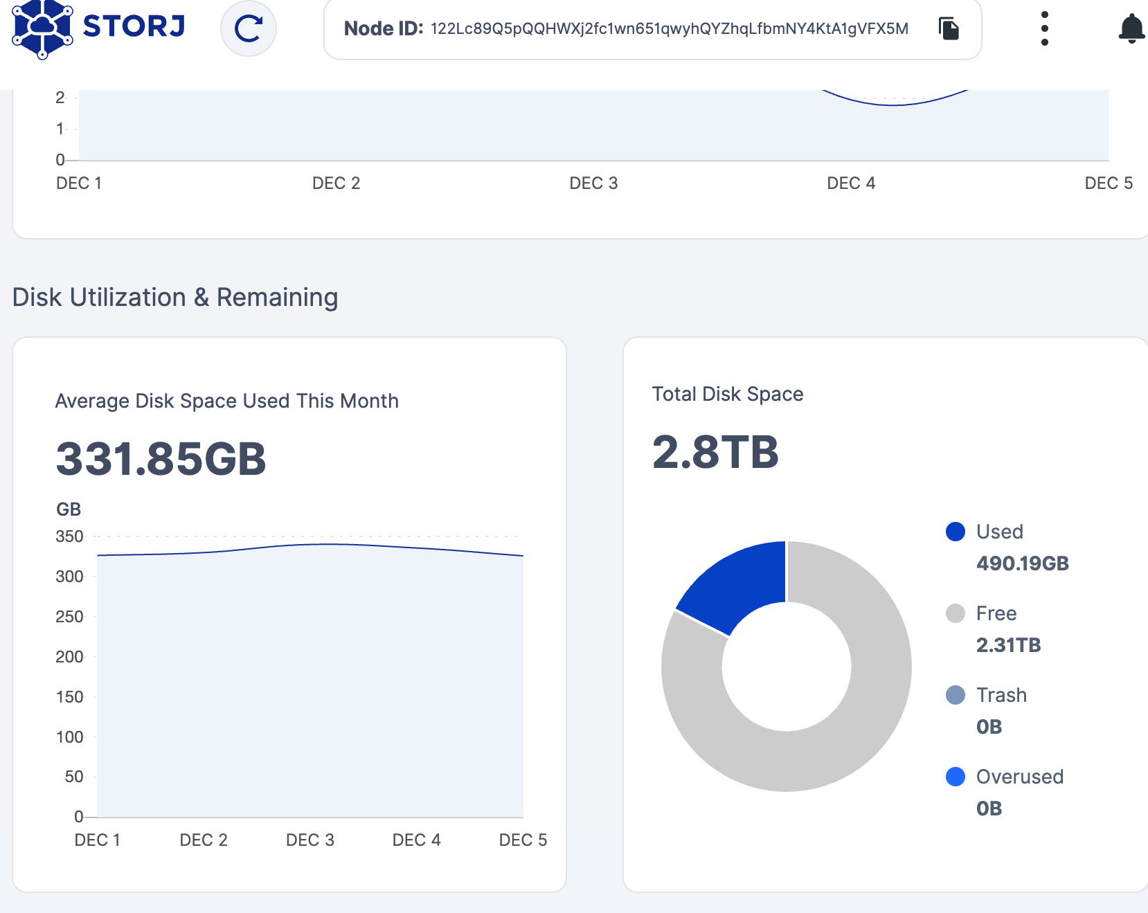

Average Disk Space Used Month - Does not change.
What to do about it?
Until filewalker would not finish its work - nothing will change.
He finished and re-read the size.
The right side shows correctly, but the left side does not change.
It also should move part (up to 90%) of the deleted data to the trash. The left side - is what your node reported as an actually used, everything above that - is deleted data, which should be moved to the trash by the garbage collector (gc-filewalker) and expiration removal (retain).
Please tell me how long I need to wait for everything unnecessary to be deleted?
I need to understand whether it is worth moving the node to another disk and enlarging it or waiting, if all that is needed is only 300Gb, then more than 1 TB will be deleted and this disk will still be normal for this node.

But within a day, the left side only became a little smaller, and the right side remained unchanged.
I’ll write later in a couple of days.

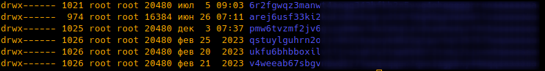

I specifically deleted the trash manually. It’s completely empty.

As a result, the question is - Why is so little indicated on the left? This is the situation for many nodes and I want to find out the reason and eliminate the overuse of unpaid space in order to free it up and then occupy it with useful data.

I checked on several nodes, on all of them the check for 4 satellites ends but nothing goes into the trash bin.
In this case, there is always a significant difference between the left side (information from the satellite) and the right side (information from the node)
The pictures show that nothing was sent to the basket! Nothing at all after a full check and completion of checking all 4 satellites - I provided the log.

What else should I try? Which version is better to search for a solution?
Что еще пробовать? На какой лучше версии проводить поиск решения?
Will ping @clement, I’m out of ideas. The satellites should send a more wide Bloom filter to your nodes after they received a report about an actual usage.
Идеи у меня пока что закончились, попрошу Clement посмотреть, что ещё может помочь. По идее после успешного завершения filewalker и отправки отчётов на сателлиты, они должны прислать более “широкий” Блюм фильтр, чтобы удалить мусор.
Ok, I’ll wait for an answer.
Thank you
Ок, буду ждать ответа.
Спасибо
I want just make sure - do you have only 4 folders inside the blobs folder, isn’t it?
Хочу уточнить, в папке blobs у вас сейчас только 4 подпапки?
yes, of course I deleted everything old with a script
да, конечно я все старое удалил скриптом
what to do if there are 6 subfoldes in the blobs folder? there is also a discrepancy
что делать, если в директории blobs 6 поддиректорий? тоже есть расхождение
