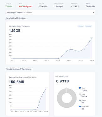

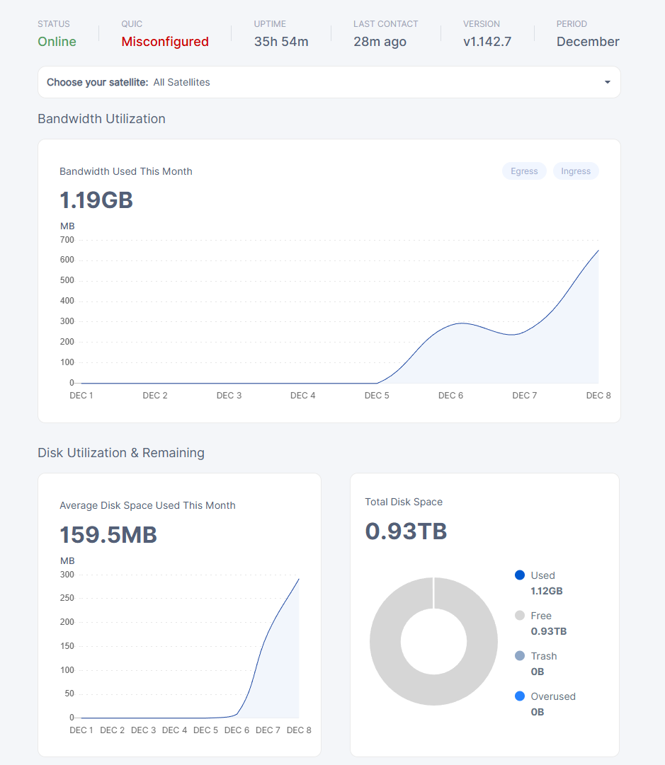

The panel displays quic with "Misconfigured" and cannot connect to the us1 eu1 node
storj sno node operation and maintenance
I’m running my node within a school in China. I’ve encountered the following problem and would appreciate some assistance:
1. The quic command appears to be unable to display its status correctly.

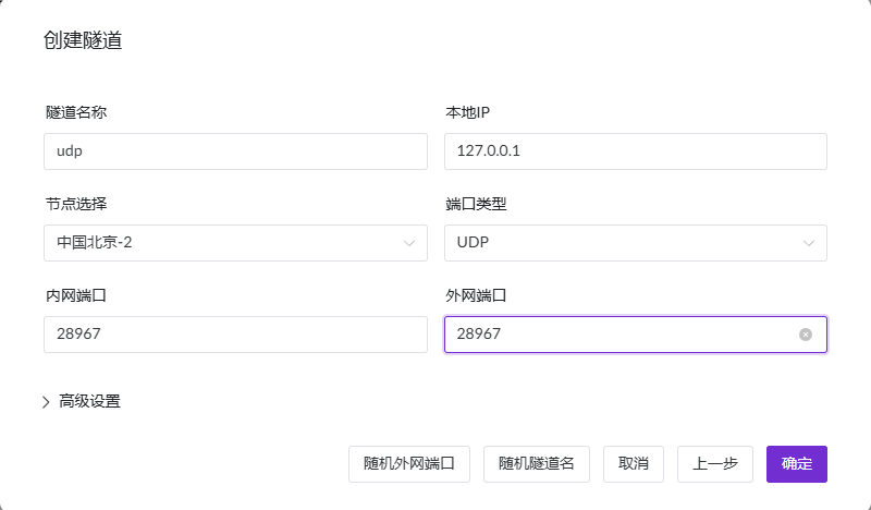

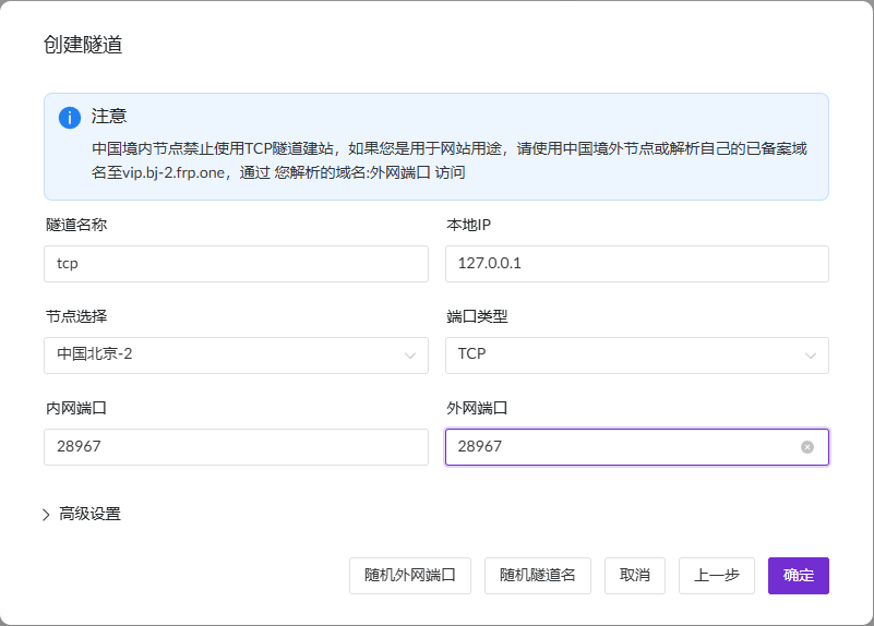

Since I don’t have admin power over the optical modem and router, I chose to rent frp server from the service provider to tunnel to the public network. Currently, I’ve selected a Hong Kong node, which forwards both TCP and UDP ports, from port 28967 on the internal network to port 38967.
However, the panel’s quic function initially indicates “ok” upon startup, but most of the time it indicates “Misconfigured,” only occasionally reverting to “ok.”
I tried using the methods mentioned in the forum to directly access the domain name to check the status and pingdom, and both showed that it was working normally. So, can I ignore this problem?

As I mentioned, I run nodes within China, but I use NAT traversal technology. This frp provider also offers frp nodes in other cities in China and frp nodes in countries such as the United States, the United Kingdom, and Japan. In the end, according to Storj, where exactly is my node located?
Hello @teacup418,
Welcome to the forum!

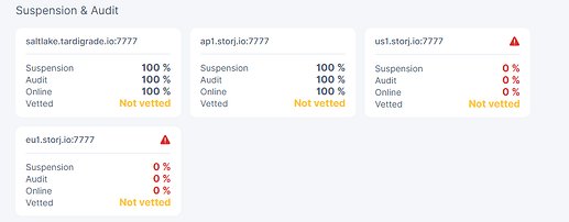

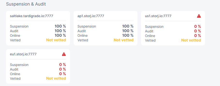

Seems you cannot run a node without a VPN - the US1 and EU1 satellites cannot contact it, and this is a bigger issue than not fully supported QUIC by your tunnel.
If these satellites cannot contact your node it will be offline for them, so it will be disqualified on them. Since Saltlake is in US too, it likely will be next.

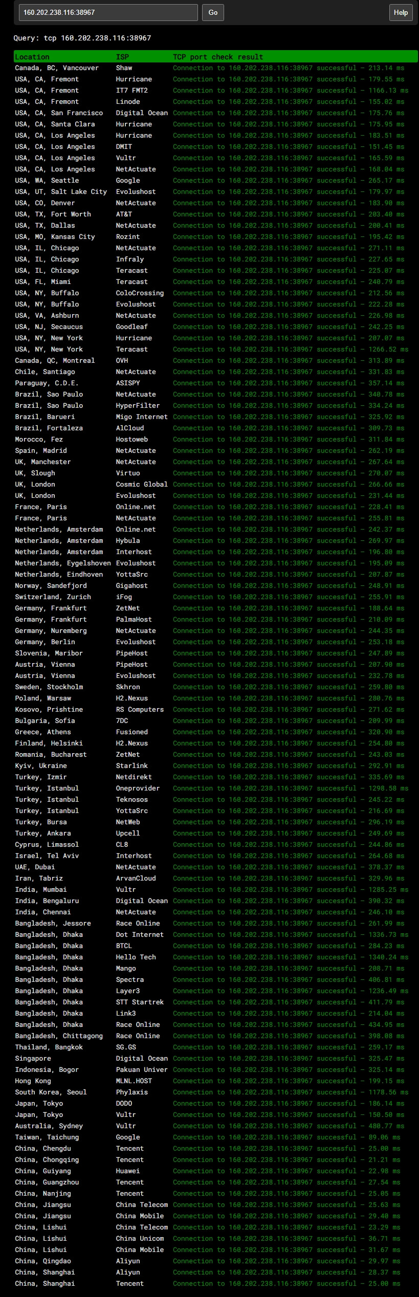

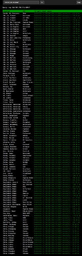

You need to test your node’s address and port outside of your network, from US and EU locations. Even the simple GET request, like you did here:
You can also check your logs for errors like “ping satellite failed”, there could be some explanation “why?” too.
Because if the satellites cannot contact your node, then the customers wouldn’t be able too.
However, your node could be affected by this satellite side issue:
So, maybe your node is properly configured, but just doesn’t receive audits to correct the online score due to this issue, especially if you do not have errors like “ping satellite failed” in your logs. In that case I would recommend to keep it running, maybe the audit issue would be identified and fixed soon.

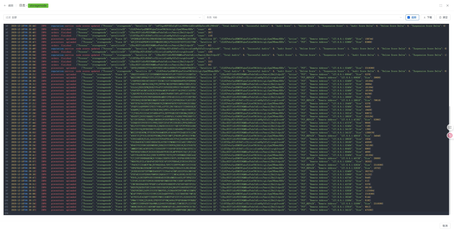

logs
Here are some important logs as follows:
These indicate that my time is not in sync.
2025-12-09T10:04:54Z	ERROR	preflight:localtime	unable to get satellite system time	{"Process": "storagenode", "Satellite ID": "12L9ZFwhzVpuEKMUNUqkaTLGzwY9G24tbiigLiXpmZWKwmcNDDs", "error": "rpc: tcp connector failed: rpc: EOF", "errorVerbose": "rpc: tcp connector failed: rpc: EOF\n\tstorj.io/common/rpc.HybridConnector.DialContext.func1:190"}
2025-12-09T10:04:54Z	ERROR	preflight:localtime	unable to get satellite system time	{"Process": "storagenode", "Satellite ID": "12EayRS2V1kEsWESU9QMRseFhdxYxKicsiFmxrsLZHeLUtdps3S", "error": "rpc: tcp connector failed: rpc: EOF", "errorVerbose": "rpc: tcp connector failed: rpc: EOF\n\tstorj.io/common/rpc.HybridConnector.DialContext.func1:190"}
2025-12-09T10:04:54Z	ERROR	preflight:localtime	unable to get satellite system time	{"Process": "storagenode", "Satellite ID": "121RTSDpyNZVcEU84Ticf2L1ntiuUimbWgfATz21tuvgk3vzoA6", "error": "rpc: tcp connector failed: rpc: EOF", "errorVerbose": "rpc: tcp connector failed: rpc: EOF\n\tstorj.io/common/rpc.HybridConnector.DialContext.func1:190"}
These say I can’t connect to the satellite:
2025-12-09T10:04:55Z	ERROR	contact:service	ping satellite failed 	{"Process": "storagenode", "Satellite ID": "12EayRS2V1kEsWESU9QMRseFhdxYxKicsiFmxrsLZHeLUtdps3S", "attempts": 1, "error": "ping satellite: rpc: tcp connector failed: rpc: EOF", "errorVerbose": "ping satellite: rpc: tcp connector failed: rpc: EOF\n\tstorj.io/common/rpc.HybridConnector.DialContext.func1:190"}
2025-12-09T10:06:15Z	ERROR	contact:service	ping satellite failed 	{"Process": "storagenode", "Satellite ID": "121RTSDpyNZVcEU84Ticf2L1ntiuUimbWgfATz21tuvgk3vzoA6", "attempts": 1, "error": "ping satellite: rpc: tcp connector failed: rpc: EOF", "errorVerbose": "ping satellite: rpc: tcp connector failed: rpc: EOF\n\tstorj.io/common/rpc.HybridConnector.DialContext.func1:190"}
2025-12-09T10:06:15Z	ERROR	contact:service	ping satellite failed 	{"Process": "storagenode", "Satellite ID": "12L9ZFwhzVpuEKMUNUqkaTLGzwY9G24tbiigLiXpmZWKwmcNDDs", "attempts": 1, "error": "ping satellite: rpc: tcp connector failed: rpc: EOF", "errorVerbose": "ping satellite: rpc: tcp connector failed: rpc: EOF\n\tstorj.io/common/rpc.HybridConnector.DialContext.func1:190"}
There are also some strange orders. It says the orders are completed, but report are failed.
2025-12-09T10:05:13Z	INFO	orders	finished	{"Process": "storagenode", "satelliteID": "12EayRS2V1kEsWESU9QMRseFhdxYxKicsiFmxrsLZHeLUtdps3S", "count": 422}
2025-12-09T10:05:13Z	ERROR	orders	failed to settle orders for satellite	{"Process": "storagenode", "satelliteID": "12EayRS2V1kEsWESU9QMRseFhdxYxKicsiFmxrsLZHeLUtdps3S", "satellite ID": "12EayRS2V1kEsWESU9QMRseFhdxYxKicsiFmxrsLZHeLUtdps3S", "error": "order: failed to start settlement: rpc: tcp connector failed: rpc: EOF", "errorVerbose": "order: failed to start settlement: rpc: tcp connector failed: rpc: EOF\n\tstorj.io/storj/storagenode/orders.(*Service).settleWindow:264\n\tstorj.io/storj/storagenode/orders.(*Service).SendOrders.func2:219\n\tgolang.org/x/sync/errgroup.(*Group).Go.func1:93"}
2025-12-09T10:06:34Z	INFO	orders	finished	{"Process": "storagenode", "satelliteID": "121RTSDpyNZVcEU84Ticf2L1ntiuUimbWgfATz21tuvgk3vzoA6", "count": 46}
2025-12-09T10:06:34Z	ERROR	orders	failed to settle orders for satellite	{"Process": "storagenode", "satelliteID": "121RTSDpyNZVcEU84Ticf2L1ntiuUimbWgfATz21tuvgk3vzoA6", "satellite ID": "121RTSDpyNZVcEU84Ticf2L1ntiuUimbWgfATz21tuvgk3vzoA6", "error": "order: failed to start settlement: rpc: tcp connector failed: rpc: EOF", "errorVerbose": "order: failed to start settlement: rpc: tcp connector failed: rpc: EOF\n\tstorj.io/storj/storagenode/orders.(*Service).settleWindow:264\n\tstorj.io/storj/storagenode/orders.(*Service).SendOrders.func2:219\n\tgolang.org/x/sync/errgroup.(*Group).Go.func1:93"}

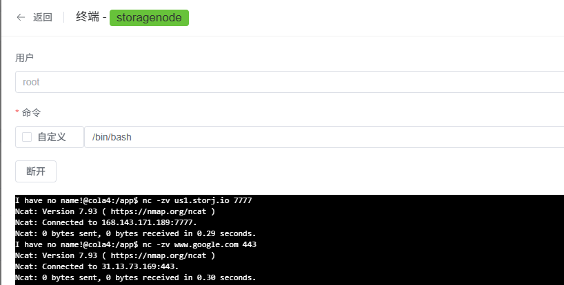

Using nc to scan inside a docker container looks like connected, but not work for ping satellite.

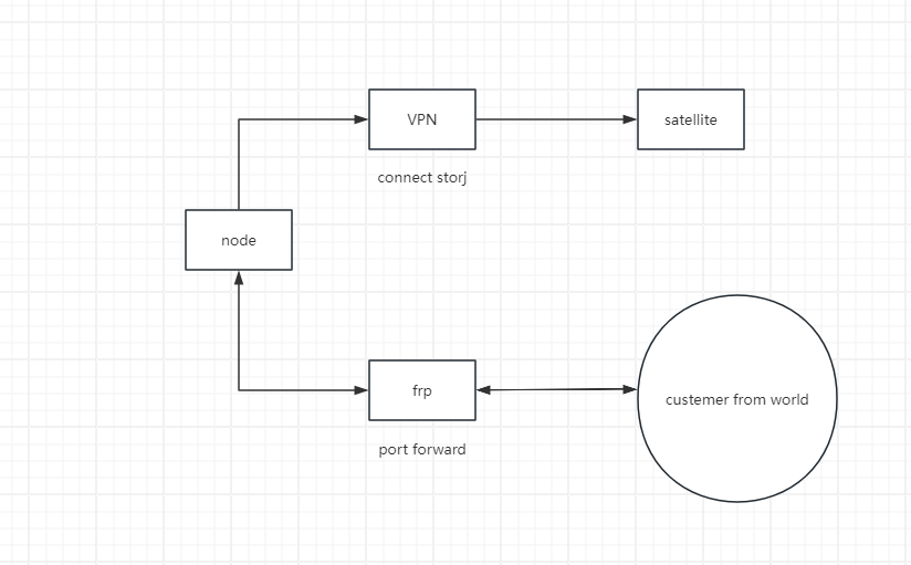

How exactly does drpc ping work? For example:
  1. node->frp server->satellite
  2. node->satellite
I’ve only deployed the VPN on node. If it’s the first option, I might need to find a different frp server. If it’s the second option, I’ll need to adjust the VPN’s routing rules.

2025-12-10T04:34:33Z INFO lazyfilewalker.trash-cleanup-filewalker.subprocess trash-filewalker completed {“Process”: “storagenode”, “satelliteID”: “12L9ZFwhzVpuEKMUNUqkaTLGzwY9G24tbiigLiXpmZWKwmcNDDs”, “Process”: “storagenode”, “bytesDeleted”: 0, “numKeysDeleted”: 0}
2025-12-10T04:34:33Z INFO lazyfilewalker.used-space-filewalker.subprocess Database started {“Process”: “storagenode”, “satelliteID”: “12EayRS2V1kEsWESU9QMRseFhdxYxKicsiFmxrsLZHeLUtdps3S”, “Process”: “storagenode”}
2025-12-10T04:34:33Z INFO lazyfilewalker.trash-cleanup-filewalker subprocess finished successfully {“Process”: “storagenode”, “satelliteID”: “12L9ZFwhzVpuEKMUNUqkaTLGzwY9G24tbiigLiXpmZWKwmcNDDs”}
2025-12-10T04:34:33Z INFO pieces:trash emptying trash finished {“Process”: “storagenode”, “Satellite ID”: “12L9ZFwhzVpuEKMUNUqkaTLGzwY9G24tbiigLiXpmZWKwmcNDDs”, “elapsed”: “125.764752ms”}
2025-12-10T04:34:33Z INFO pieces:trash emptying trash started {“Process”: “storagenode”, “Satellite ID”: “1wFTAgs9DP5RSnCqKV1eLf6N9wtk4EAtmN5DpSxcs8EjT69tGE”}
2025-12-10T04:34:33Z INFO lazyfilewalker.trash-cleanup-filewalker starting subprocess {“Process”: “storagenode”, “satelliteID”: “1wFTAgs9DP5RSnCqKV1eLf6N9wtk4EAtmN5DpSxcs8EjT69tGE”}
2025-12-10T04:34:33Z INFO lazyfilewalker.trash-cleanup-filewalker subprocess started {“Process”: “storagenode”, “satelliteID”: “1wFTAgs9DP5RSnCqKV1eLf6N9wtk4EAtmN5DpSxcs8EjT69tGE”}
2025-12-10T04:34:33Z INFO lazyfilewalker.trash-cleanup-filewalker.subprocess trash-filewalker started {“Process”: “storagenode”, “satelliteID”: “1wFTAgs9DP5RSnCqKV1eLf6N9wtk4EAtmN5DpSxcs8EjT69tGE”, “Process”: “storagenode”, “dateBefore”: “2025-12-03T04:34:33Z”}
2025-12-10T04:34:33Z INFO lazyfilewalker.trash-cleanup-filewalker.subprocess Database started {“Process”: “storagenode”, “satelliteID”: “1wFTAgs9DP5RSnCqKV1eLf6N9wtk4EAtmN5DpSxcs8EjT69tGE”, “Process”: “storagenode”}
2025-12-10T04:34:33Z INFO lazyfilewalker.trash-cleanup-filewalker.subprocess trash-filewalker completed {“Process”: “storagenode”, “satelliteID”: “1wFTAgs9DP5RSnCqKV1eLf6N9wtk4EAtmN5DpSxcs8EjT69tGE”, “numKeysDeleted”: 0, “Process”: “storagenode”, “bytesDeleted”: 0}
2025-12-10T04:34:33Z INFO lazyfilewalker.used-space-filewalker subprocess finished successfully {“Process”: “storagenode”, “satelliteID”: “12EayRS2V1kEsWESU9QMRseFhdxYxKicsiFmxrsLZHeLUtdps3S”}
2025-12-10T04:34:33Z INFO pieces used-space-filewalker completed {“Process”: “storagenode”, “Satellite ID”: “12EayRS2V1kEsWESU9QMRseFhdxYxKicsiFmxrsLZHeLUtdps3S”, “Lazy File Walker”: true, “Total Pieces Size”: 466369044, “Total Pieces Content Size”: 465704980, “Total Pieces Count”: 1297, “Duration”: “224.987274ms”}
2025-12-10T04:34:33Z INFO pieces used-space-filewalker started {“Process”: “storagenode”, “Satellite ID”: “1wFTAgs9DP5RSnCqKV1eLf6N9wtk4EAtmN5DpSxcs8EjT69tGE”}
2025-12-10T04:34:33Z INFO lazyfilewalker.used-space-filewalker starting subprocess {“Process”: “storagenode”, “satelliteID”: “1wFTAgs9DP5RSnCqKV1eLf6N9wtk4EAtmN5DpSxcs8EjT69tGE”}
2025-12-10T04:34:33Z INFO lazyfilewalker.used-space-filewalker subprocess started {“Process”: “storagenode”, “satelliteID”: “1wFTAgs9DP5RSnCqKV1eLf6N9wtk4EAtmN5DpSxcs8EjT69tGE”}
2025-12-10T04:34:33Z INFO lazyfilewalker.trash-cleanup-filewalker subprocess finished successfully {“Process”: “storagenode”, “satelliteID”: “1wFTAgs9DP5RSnCqKV1eLf6N9wtk4EAtmN5DpSxcs8EjT69tGE”}
2025-12-10T04:34:33Z INFO pieces:trash emptying trash finished {“Process”: “storagenode”, “Satellite ID”: “1wFTAgs9DP5RSnCqKV1eLf6N9wtk4EAtmN5DpSxcs8EjT69tGE”, “elapsed”: “110.958201ms”}
2025-12-10T04:34:33Z INFO pieces:trash emptying trash started {“Process”: “storagenode”, “Satellite ID”: “121RTSDpyNZVcEU84Ticf2L1ntiuUimbWgfATz21tuvgk3vzoA6”}
2025-12-10T04:34:33Z INFO lazyfilewalker.trash-cleanup-filewalker starting subprocess {“Process”: “storagenode”, “satelliteID”: “121RTSDpyNZVcEU84Ticf2L1ntiuUimbWgfATz21tuvgk3vzoA6”}
2025-12-10T04:34:33Z INFO lazyfilewalker.trash-cleanup-filewalker subprocess started {“Process”: “storagenode”, “satelliteID”: “121RTSDpyNZVcEU84Ticf2L1ntiuUimbWgfATz21tuvgk3vzoA6”}
2025-12-10T04:34:33Z INFO lazyfilewalker.trash-cleanup-filewalker.subprocess trash-filewalker started {“Process”: “storagenode”, “satelliteID”: “121RTSDpyNZVcEU84Ticf2L1ntiuUimbWgfATz21tuvgk3vzoA6”, “Process”: “storagenode”, “dateBefore”: “2025-12-03T04:34:33Z”}
2025-12-10T04:34:33Z INFO lazyfilewalker.trash-cleanup-filewalker.subprocess Database started {“Process”: “storagenode”, “satelliteID”: “121RTSDpyNZVcEU84Ticf2L1ntiuUimbWgfATz21tuvgk3vzoA6”, “Process”: “storagenode”}
2025-12-10T04:34:33Z INFO lazyfilewalker.trash-cleanup-filewalker.subprocess trash-filewalker completed {“Process”: “storagenode”, “satelliteID”: “121RTSDpyNZVcEU84Ticf2L1ntiuUimbWgfATz21tuvgk3vzoA6”, “bytesDeleted”: 0, “numKeysDeleted”: 0, “Process”: “storagenode”}
2025-12-10T04:34:33Z INFO lazyfilewalker.used-space-filewalker.subprocess Database started {“Process”: “storagenode”, “satelliteID”: “1wFTAgs9DP5RSnCqKV1eLf6N9wtk4EAtmN5DpSxcs8EjT69tGE”, “Process”: “storagenode”}
2025-12-10T04:34:33Z INFO lazyfilewalker.trash-cleanup-filewalker subprocess finished successfully {“Process”: “storagenode”, “satelliteID”: “121RTSDpyNZVcEU84Ticf2L1ntiuUimbWgfATz21tuvgk3vzoA6”}
2025-12-10T04:34:33Z INFO pieces:trash emptying trash finished {“Process”: “storagenode”, “Satellite ID”: “121RTSDpyNZVcEU84Ticf2L1ntiuUimbWgfATz21tuvgk3vzoA6”, “elapsed”: “115.820443ms”}
2025-12-10T04:34:33Z INFO pieces:trash emptying trash started {“Process”: “storagenode”, “Satellite ID”: “12EayRS2V1kEsWESU9QMRseFhdxYxKicsiFmxrsLZHeLUtdps3S”}
2025-12-10T04:34:33Z INFO lazyfilewalker.trash-cleanup-filewalker starting subprocess {“Process”: “storagenode”, “satelliteID”: “12EayRS2V1kEsWESU9QMRseFhdxYxKicsiFmxrsLZHeLUtdps3S”}
2025-12-10T04:34:33Z INFO lazyfilewalker.trash-cleanup-filewalker subprocess started {“Process”: “storagenode”, “satelliteID”: “12EayRS2V1kEsWESU9QMRseFhdxYxKicsiFmxrsLZHeLUtdps3S”}
2025-12-10T04:34:33Z INFO lazyfilewalker.used-space-filewalker subprocess finished successfully {“Process”: “storagenode”, “satelliteID”: “1wFTAgs9DP5RSnCqKV1eLf6N9wtk4EAtmN5DpSxcs8EjT69tGE”}
2025-12-10T04:34:33Z INFO pieces used-space-filewalker completed {“Process”: “storagenode”, “Satellite ID”: “1wFTAgs9DP5RSnCqKV1eLf6N9wtk4EAtmN5DpSxcs8EjT69tGE”, “Lazy File Walker”: true, “Total Pieces Size”: 604409344, “Total Pieces Content Size”: 604274688, “Total Pieces Count”: 263, “Duration”: “165.029989ms”}
2025-12-10T04:34:33Z INFO pieces used-space-filewalker started {“Process”: “storagenode”, “Satellite ID”: “12L9ZFwhzVpuEKMUNUqkaTLGzwY9G24tbiigLiXpmZWKwmcNDDs”}
2025-12-10T04:34:33Z INFO lazyfilewalker.used-space-filewalker starting subprocess {“Process”: “storagenode”, “satelliteID”: “12L9ZFwhzVpuEKMUNUqkaTLGzwY9G24tbiigLiXpmZWKwmcNDDs”}
2025-12-10T04:34:33Z INFO lazyfilewalker.used-space-filewalker subprocess started {“Process”: “storagenode”, “satelliteID”: “12L9ZFwhzVpuEKMUNUqkaTLGzwY9G24tbiigLiXpmZWKwmcNDDs”}
2025-12-10T04:34:33Z INFO lazyfilewalker.trash-cleanup-filewalker.subprocess trash-filewalker started {“Process”: “storagenode”, “satelliteID”: “12EayRS2V1kEsWESU9QMRseFhdxYxKicsiFmxrsLZHeLUtdps3S”, “Process”: “storagenode”, “dateBefore”: “2025-12-03T04:34:33Z”}
2025-12-10T04:34:33Z INFO lazyfilewalker.trash-cleanup-filewalker.subprocess Database started {“Process”: “storagenode”, “satelliteID”: “12EayRS2V1kEsWESU9QMRseFhdxYxKicsiFmxrsLZHeLUtdps3S”, “Process”: “storagenode”}
2025-12-10T04:34:33Z INFO lazyfilewalker.trash-cleanup-filewalker.subprocess trash-filewalker completed {“Process”: “storagenode”, “satelliteID”: “12EayRS2V1kEsWESU9QMRseFhdxYxKicsiFmxrsLZHeLUtdps3S”, “Process”: “storagenode”, “bytesDeleted”: 0, “numKeysDeleted”: 0}
2025-12-10T04:34:33Z INFO lazyfilewalker.trash-cleanup-filewalker subprocess finished successfully {“Process”: “storagenode”, “satelliteID”: “12EayRS2V1kEsWESU9QMRseFhdxYxKicsiFmxrsLZHeLUtdps3S”}
2025-12-10T04:34:33Z INFO pieces:trash emptying trash finished {“Process”: “storagenode”, “Satellite ID”: “12EayRS2V1kEsWESU9QMRseFhdxYxKicsiFmxrsLZHeLUtdps3S”, “elapsed”: “123.159996ms”}
2025-12-10T04:34:33Z INFO lazyfilewalker.used-space-filewalker.subprocess Database started {“Process”: “storagenode”, “satelliteID”: “12L9ZFwhzVpuEKMUNUqkaTLGzwY9G24tbiigLiXpmZWKwmcNDDs”, “Process”: “storagenode”}
2025-12-10T04:34:33Z INFO lazyfilewalker.used-space-filewalker subprocess finished successfully {“Process”: “storagenode”, “satelliteID”: “12L9ZFwhzVpuEKMUNUqkaTLGzwY9G24tbiigLiXpmZWKwmcNDDs”}
2025-12-10T04:34:33Z INFO pieces used-space-filewalker completed {“Process”: “storagenode”, “Satellite ID”: “12L9ZFwhzVpuEKMUNUqkaTLGzwY9G24tbiigLiXpmZWKwmcNDDs”, “Lazy File Walker”: true, “Total Pieces Size”: 8364288, “Total Pieces Content Size”: 8327936, “Total Pieces Count”: 71, “Duration”: “117.383354ms”}
2025-12-10T04:34:33Z INFO pieces used-space-filewalker started {“Process”: “storagenode”, “Satellite ID”: “121RTSDpyNZVcEU84Ticf2L1ntiuUimbWgfATz21tuvgk3vzoA6”}
2025-12-10T04:34:33Z INFO lazyfilewalker.used-space-filewalker starting subprocess {“Process”: “storagenode”, “satelliteID”: “121RTSDpyNZVcEU84Ticf2L1ntiuUimbWgfATz21tuvgk3vzoA6”}
2025-12-10T04:34:33Z INFO lazyfilewalker.used-space-filewalker subprocess started {“Process”: “storagenode”, “satelliteID”: “121RTSDpyNZVcEU84Ticf2L1ntiuUimbWgfATz21tuvgk3vzoA6”}
2025-12-10T04:34:33Z INFO lazyfilewalker.used-space-filewalker.subprocess Database started {“Process”: “storagenode”, “satelliteID”: “121RTSDpyNZVcEU84Ticf2L1ntiuUimbWgfATz21tuvgk3vzoA6”, “Process”: “storagenode”}
2025-12-10T04:34:34Z INFO lazyfilewalker.used-space-filewalker subprocess finished successfully {“Process”: “storagenode”, “satelliteID”: “121RTSDpyNZVcEU84Ticf2L1ntiuUimbWgfATz21tuvgk3vzoA6”}
2025-12-10T04:34:34Z INFO pieces used-space-filewalker completed {“Process”: “storagenode”, “Satellite ID”: “121RTSDpyNZVcEU84Ticf2L1ntiuUimbWgfATz21tuvgk3vzoA6”, “Lazy File Walker”: true, “Total Pieces Size”: 174146304, “Total Pieces Content Size”: 173893888, “Total Pieces Count”: 493, “Duration”: “183.418749ms”}
2025-12-10T04:35:43Z INFO orders finished {“Process”: “storagenode”, “satelliteID”: “12EayRS2V1kEsWESU9QMRseFhdxYxKicsiFmxrsLZHeLUtdps3S”, “count”: 422}
2025-12-10T04:35:43Z ERROR orders failed to settle orders for satellite {“Process”: “storagenode”, “satelliteID”: “12EayRS2V1kEsWESU9QMRseFhdxYxKicsiFmxrsLZHeLUtdps3S”, “satellite ID”: “12EayRS2V1kEsWESU9QMRseFhdxYxKicsiFmxrsLZHeLUtdps3S”, “error”: “order: failed to start settlement: rpc: tcp connector failed: rpc: EOF”, “errorVerbose”: “order: failed to start settlement: rpc: tcp connector failed: rpc: EOF\n\tstorj.io/storj/storagenode/orders.(*Service).settleWindow:264\n\tstorj.io/storj/storagenode/orders.(*Service).SendOrders.func2:219\n\tgolang.org/x/sync/errgroup.(*Group).Go.func1:93”}
2025-12-10T04:35:43Z INFO orders finished {“Process”: “storagenode”, “satelliteID”: “121RTSDpyNZVcEU84Ticf2L1ntiuUimbWgfATz21tuvgk3vzoA6”, “count”: 175}
2025-12-10T04:35:43Z ERROR orders failed to settle orders for satellite {“Process”: “storagenode”, “satelliteID”: “121RTSDpyNZVcEU84Ticf2L1ntiuUimbWgfATz21tuvgk3vzoA6”, “satellite ID”: “121RTSDpyNZVcEU84Ticf2L1ntiuUimbWgfATz21tuvgk3vzoA6”, “error”: “order: failed to start settlement: rpc: tcp connector failed: rpc: EOF”, “errorVerbose”: “order: failed to start settlement: rpc: tcp connector failed: rpc: EOF\n\tstorj.io/storj/storagenode/orders.(*Service).settleWindow:264\n\tstorj.io/storj/storagenode/orders.(*Service).SendOrders.func2:219\n\tgolang.org/x/sync/errgroup.(*Group).Go.func1:93”}
2025-12-10T04:35:43Z ERROR contact:service ping satellite failed {“Process”: “storagenode”, “Satellite ID”: “12L9ZFwhzVpuEKMUNUqkaTLGzwY9G24tbiigLiXpmZWKwmcNDDs”, “attempts”: 1, “error”: “ping satellite: rpc: tcp connector failed: rpc: EOF”, “errorVerbose”: “ping satellite: rpc: tcp connector failed: rpc: EOF\n\tstorj.io/common/rpc.HybridConnector.DialContext.func1:190”}
2025-12-10T04:35:43Z ERROR contact:service ping satellite failed {“Process”: “storagenode”, “Satellite ID”: “12EayRS2V1kEsWESU9QMRseFhdxYxKicsiFmxrsLZHeLUtdps3S”, “attempts”: 1, “error”: “ping satellite: rpc: tcp connector failed: rpc: EOF”, “errorVerbose”: “ping satellite: rpc: tcp connector failed: rpc: EOF\n\tstorj.io/common/rpc.HybridConnector.DialContext.func1:190”}
2025-12-10T04:35:43Z INFO orders finished {“Process”: “storagenode”, “satelliteID”: “12L9ZFwhzVpuEKMUNUqkaTLGzwY9G24tbiigLiXpmZWKwmcNDDs”, “count”: 84}
2025-12-10T04:35:43Z ERROR orders failed to settle orders for satellite {“Process”: “storagenode”, “satelliteID”: “12L9ZFwhzVpuEKMUNUqkaTLGzwY9G24tbiigLiXpmZWKwmcNDDs”, “satellite ID”: “12L9ZFwhzVpuEKMUNUqkaTLGzwY9G24tbiigLiXpmZWKwmcNDDs”, “error”: “order: failed to start settlement: rpc: tcp connector failed: rpc: EOF”, “errorVerbose”: “order: failed to start settlement: rpc: tcp connector failed: rpc: EOF\n\tstorj.io/storj/storagenode/orders.(*Service).settleWindow:264\n\tstorj.io/storj/storagenode/orders.(*Service).SendOrders.func2:219\n\tgolang.org/x/sync/errgroup.(*Group).Go.func1:93”}
2025-12-10T04:35:44Z ERROR contact:service ping satellite failed {“Process”: “storagenode”, “Satellite ID”: “121RTSDpyNZVcEU84Ticf2L1ntiuUimbWgfATz21tuvgk3vzoA6”, “attempts”: 1, “error”: “ping satellite: rpc: tcp connector failed: rpc: EOF”, “errorVerbose”: “ping satellite: rpc: tcp connector failed: rpc: EOF\n\tstorj.io/common/rpc.HybridConnector.DialContext.func1:190”}
2025-12-10T04:36:07Z INFO reputation:service node scores updated {“Process”: “storagenode”, “Satellite ID”: “1wFTAgs9DP5RSnCqKV1eLf6N9wtk4EAtmN5DpSxcs8EjT69tGE”, “Total Audits”: 0, “Successful Audits”: 0, “Audit Score”: 1, “Online Score”: 1, “Suspension Score”: 1, “Audit Score Delta”: 0, “Online Score Delta”: 0, “Suspension Score Delta”: 0}
2025-12-10T04:38:36Z ERROR nodestats:cache Get pricing-model/join date failed {“Process”: “storagenode”, “error”: “payouts service: rpc: tcp connector failed: rpc: EOF; payouts service: rpc: tcp connector failed: rpc: EOF; payouts service: rpc: tcp connector failed: rpc: EOF”, “errorVerbose”: “group:\n— payouts service: rpc: tcp connector failed: rpc: EOF\n\tstorj.io/common/rpc.HybridConnector.DialContext.func1:190\n— payouts service: rpc: tcp connector failed: rpc: EOF\n\tstorj.io/common/rpc.HybridConnector.DialContext.func1:190\n— payouts service: rpc: tcp connector failed: rpc: EOF\n\tstorj.io/common/rpc.HybridConnector.DialContext.func1:190”}
2025-12-10T04:39:37Z ERROR reputation:chore reputation chore failed {“Process”: “storagenode”, “error”: “reputation: rpc: tcp connector failed: rpc: EOF; reputation: rpc: tcp connector failed: rpc: EOF; reputation: rpc: tcp connector failed: rpc: EOF”, “errorVerbose”: “group:\n— reputation: rpc: tcp connector failed: rpc: EOF\n\tstorj.io/common/rpc.HybridConnector.DialContext.func1:190\n— reputation: rpc: tcp connector failed: rpc: EOF\n\tstorj.io/common/rpc.HybridConnector.DialContext.func1:190\n— reputation: rpc: tcp connector failed: rpc: EOF\n\tstorj.io/common/rpc.HybridConnector.DialContext.func1:190”}
2025-12-10T04:43:52Z ERROR nodestats:cache Get disk space usage query failed {“Process”: “storagenode”, “error”: “nodestats: rpc: tcp connector failed: rpc: EOF; nodestats: rpc: tcp connector failed: rpc: EOF; nodestats: rpc: tcp connector failed: rpc: EOF”, “errorVerbose”: “group:\n— nodestats: rpc: tcp connector failed: rpc: EOF\n\tstorj.io/common/rpc.HybridConnector.DialContext.func1:190\n— nodestats: rpc: tcp connector failed: rpc: EOF\n\tstorj.io/common/rpc.HybridConnector.DialContext.func1:190\n— nodestats: rpc: tcp connector failed: rpc: EOF\n\tstorj.io/common/rpc.HybridConnector.DialContext.func1:190”}
2025-12-10T04:44:33Z INFO piecemigrate:chore all enqueued for migration; will sleep before next pooling {“Process”: “storagenode”, “active”: {“12L9ZFwhzVpuEKMUNUqkaTLGzwY9G24tbiigLiXpmZWKwmcNDDs”: false, “1wFTAgs9DP5RSnCqKV1eLf6N9wtk4EAtmN5DpSxcs8EjT69tGE”: false, “121RTSDpyNZVcEU84Ticf2L1ntiuUimbWgfATz21tuvgk3vzoA6”: false, “12EayRS2V1kEsWESU9QMRseFhdxYxKicsiFmxrsLZHeLUtdps3S”: false}, “interval”: “10m0s”}
2025-12-10T04:45:13Z ERROR nodestats:cache payouts err {“Process”: “storagenode”, “satellite”: “121RTSDpyNZVcEU84Ticf2L1ntiuUimbWgfATz21tuvgk3vzoA6”}
2025-12-10T04:46:24Z ERROR nodestats:cache payouts err {“Process”: “storagenode”, “satellite”: “12EayRS2V1kEsWESU9QMRseFhdxYxKicsiFmxrsLZHeLUtdps3S”}
2025-12-10T04:47:34Z ERROR nodestats:cache payouts err {“Process”: “storagenode”, “satellite”: “12L9ZFwhzVpuEKMUNUqkaTLGzwY9G24tbiigLiXpmZWKwmcNDDs”}
2025-12-10T04:47:34Z ERROR nodestats:cache Get held amount query failed {“Process”: “storagenode”, “error”: “payouts service: rpc: tcp connector failed: rpc: EOF; payouts service: rpc: tcp connector failed: rpc: EOF; payouts service: rpc: tcp connector failed: rpc: EOF”, “errorVerbose”: “group:\n— payouts service: rpc: tcp connector failed: rpc: EOF\n\tstorj.io/common/rpc.HybridConnector.DialContext.func1:190\n— payouts service: rpc: tcp connector failed: rpc: EOF\n\tstorj.io/common/rpc.HybridConnector.DialContext.func1:190\n— payouts service: rpc: tcp connector failed: rpc: EOF\n\tstorj.io/common/rpc.HybridConnector.DialContext.func1:190”}
2025-12-10T04:47:58Z INFO Downloading versions. {“Process”: “storagenode-updater”, “Server Address”: “https://version.storj.io”}
2025-12-10T04:48:10Z INFO Current binary version {“Process”: “storagenode-updater”, “Service”: “storagenode”, “Version”: “v1.142.7”}
2025-12-10T04:48:10Z INFO Version is up to date {“Process”: “storagenode-updater”, “Service”: “storagenode”}
2025-12-10T04:48:10Z INFO Current binary version {“Process”: “storagenode-updater”, “Service”: “storagenode-updater”, “Version”: “v1.142.7”}
2025-12-10T04:48:10Z INFO Version is up to date {“Process”: “storagenode-updater”, “Service”: “storagenode-updater”}
The node contacts the satellite - sends DRPC check-in every hour and provides orders with usage, free space, the external address and port, etc., then the satellite sends DRPC ping to the node using the provided external address and port, then respond to the node with the result and reputation scores (audit, suspension and online scores). If everything is ok, the node compare clocks with the satellite.
So, when you see an error “ping satellite failed” in the log, this is mean that the satellite was unable to receive a respond from your node on DRPC Ping request from the satellite.
So, seems http is passed, but accordingly the node’s logs DRPC is not. Is it possible that your proxy/VPN can pass only http(s) traffic, but blocks everything else?
Usually you need to use a VPN with port-forwading like portmap.io, ngrok, PIA, AirVPN, PureVPN, etc. to bypass CGNAT.
new status, I saw these info, was it work?
It looks like yes, I see successful PUT requests.
I know why now, it’s because DNS. Everything else is find, but GFW break my DNS.
Can I document this experience? It might be valuable to others.
Yes, you can post it in this topic and mark as a solution. The only problem is cost, you likely will spent more on VPN, than this node can earn.
Is that possible? My VPN only proxies Storj’s satellite traffic; frp is directly exposed globally. Shouldn’t the main data pass through frp, not the VPN?
My VPN costs approximately $2.85 per TB. I have paid separately for frp hosting(like ngork), and there is no data limit.
Yes, the satellite doesn’t transfer customers data.
And you can earn $1.5/TB*mo of the stored data, of course there shouldn’t be much of the traffic to the satellite, but I do not know for sure. Seems you will see.
Since I’m using intranet penetration technology, does that mean that if someone else uses the same frp node from the same provider as me to expose a port, my node will be considered the same node for inbound traffic as theirs?
it ip will be in same /24 then yes.
That is the downside of FRP if the exit IP is shared you are fighting for the same slice of the pie
Hello @matijasever55,
Not the exit IP, the satellite check the provided external address, so it’s in a reverse direction.

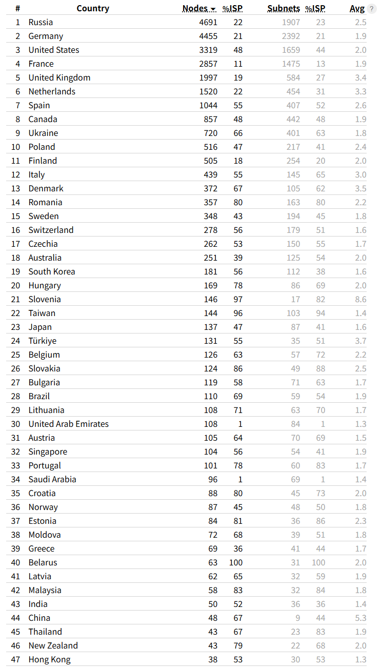

Storj is a rather niche project in China. According to statistics from storjnet.info, as of the writing date (December 24, 2025), there are only 48 nodes in mainland China, ranking 44th globally.
One contributing factor is the extremely high cost of commercial bandwidth in China, which has given rise to PCDN, a far more profitable alternative project.

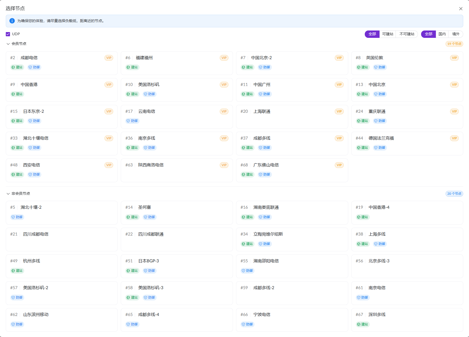

I use the managed frp service chmlfrp, which offers unlimited traffic and flexible bandwidth limits: 128 Mbps for international traffic and 32 Mbps for domestic traffic.
Tunnel Configuration
You can copy my configuration directly or adjust it as needed.

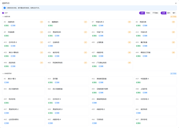

Add a tunnel and select a node that supports UDP.
Create two separate tunnels with identical internal and external ports, using TCP and UDP protocols respectively.
Generate your frpc configuration file (example below):
[common]
server_addr = <ip>
server_port = <port>
tls_enable = false
user = <user>
token = <token>
[storj_tcp]
type = tcp
local_ip = 127.0.0.1
local_port = 28967
remote_port = 28967
[storj_udp]
type = udp
local_port = 28967
remote_port = 28967

2025-12-21T15:18:24Z	INFO	Current binary version	{"Process": "storagenode-updater", "Service": "storagenode", "Version": "v1.142.7"}
2025-12-21T15:18:24Z	INFO	Version is up to date	{"Process": "storagenode-updater", "Service": "storagenode"}
2025-12-21T15:18:24Z	INFO	Current binary version	{"Process": "storagenode-updater", "Service": "storagenode-updater", "Version": "v1.142.7"}
2025-12-21T15:18:24Z	INFO	Version is up to date	{"Process": "storagenode-updater", "Service": "storagenode-updater"}
2025-12-21T15:18:59Z	INFO	piecestore	uploaded	{"Process": "storagenode", "Piece ID": "BNERV6D3IQGORXMICYMR6FGFMLOVV6MUB3XMM6IRXDJBVDPJZ2KQ", "Satellite ID": "12EayRS2V1kEsWESU9QMRseFhdxYxKicsiFmxrsLZHeLUtdps3S", "Action": "PUT", "Remote Address": "172.17.0.1:41080", "Size": 32512}
2025-12-21T15:21:09Z	INFO	piecestore	downloaded	{"Process": "storagenode", "Piece ID": "QHDD2YN7WG7JNBOFX3PJZ5FZQM423KWU3JLHML5KRFWCNAO7MRJQ", "Satellite ID": "1wFTAgs9DP5RSnCqKV1eLf6N9wtk4EAtmN5DpSxcs8EjT69tGE", "Action": "GET_AUDIT", "Offset": 758272, "Size": 256, "Remote Address": "172.17.0.1:41318"}
2025-12-21T15:23:00Z	INFO	piecestore	download canceled	{"Process": "storagenode", "Piece ID": "G55JQHFQYHGF63SEVF2Y2WE3IX62NLD7LSHDRQR52TRKQCOSTJ4Q", "Satellite ID": "12EayRS2V1kEsWESU9QMRseFhdxYxKicsiFmxrsLZHeLUtdps3S", "Action": "GET", "Offset": 0, "Size": 7936, "Remote Address": "172.17.0.1:48620", "reason": "downloaded size (0 bytes) does not match received message size (7936 bytes)"}
2025-12-21T15:43:38Z	INFO	piecestore	upload canceled	{"Process": "storagenode", "Piece ID": "VKEVYEKTPFUNEGQWKX56S4QILEOXOQFE7IZMGZS2TVPPIQRPN5UQ", "Satellite ID": "12EayRS2V1kEsWESU9QMRseFhdxYxKicsiFmxrsLZHeLUtdps3S", "Action": "PUT", "Remote Address": "172.17.0.1:53694", "Size": 2293760}
2025-12-21T15:19:03Z	INFO	orders	finished	{"Process": "storagenode", "satelliteID": "1wFTAgs9DP5RSnCqKV1eLf6N9wtk4EAtmN5DpSxcs8EjT69tGE", "count": 13}
2025-12-21T15:19:03Z	INFO	orders	finished	{"Process": "storagenode", "satelliteID": "12L9ZFwhzVpuEKMUNUqkaTLGzwY9G24tbiigLiXpmZWKwmcNDDs", "count": 118}
2025-12-21T15:19:03Z	INFO	orders	finished	{"Process": "storagenode", "satelliteID": "121RTSDpyNZVcEU84Ticf2L1ntiuUimbWgfATz21tuvgk3vzoA6", "count": 63}
2025-12-21T15:19:03Z	INFO	orders	finished	{"Process": "storagenode", "satelliteID": "12EayRS2V1kEsWESU9QMRseFhdxYxKicsiFmxrsLZHeLUtdps3S", "count": 461}
