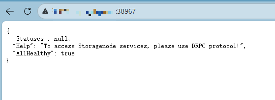

The panel displays quic with "Misconfigured" and cannot connect to the us1 eu1 node
You need to test your node’s address and port outside of your network, from US and EU locations. Even the simple GET request, like you did here:
